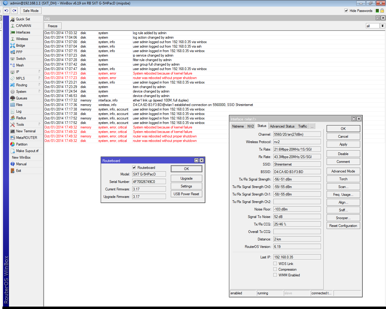

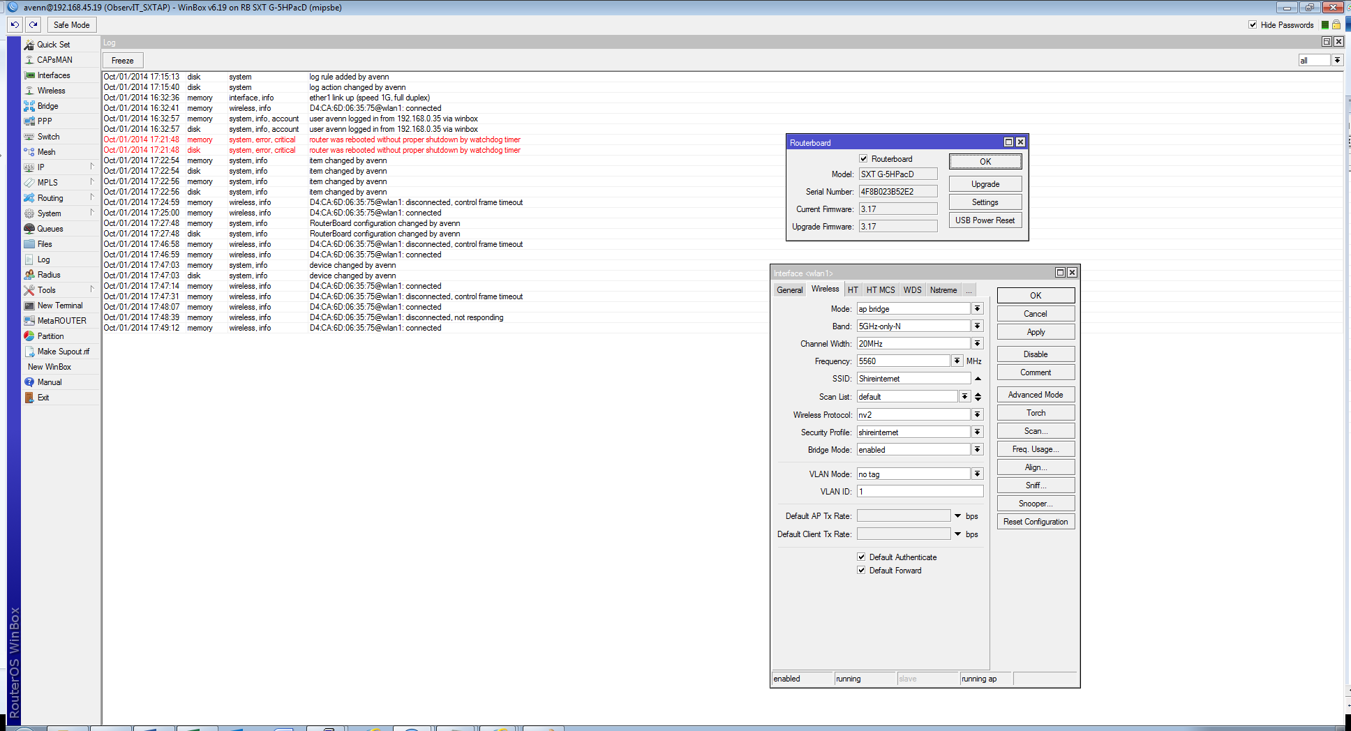

I to have same/similar problem. Kernel failure - AP and Client SUPPORT.inf files attached
Using SXT G-5HPacD sectorial to one client using SXT G-5HPacD.
switched to 802.11n - no success
switched to 2omhz channels - this ACTUALLY CAUSED kernel failure
100 metres distance
checked radio noise - nice and clear
when I do BW test with 951s at each end to client falls over - this ACTUALLY CAUSED kernel failure.
see pics of AP and client
If 6.20 no fix then back to supplier and might have to pick AirMAX but would prefer not to. No choice.
Regards
Aidan

At first
i would upgrade to the latest rc.
next i would reset configuration to default on both devices. (because client cpu-frequency: 500MHz)
as i understand the 10.x adresses is for communication between sxt via wireless?
where are located both devices? (distance) environment is noisy?
Then use AC/Ceee bandwidth on both devices.
adaptive-noise-immunity= change to ap and client on ap and client on client side.
The frequency:
the devices not working very well on the same channel with other, so check with scanner and choose free band.
use nv2
nv2-security=must_use and nv2-cell-radius=10 (because distance=7) tdma-period-size=2
set tx-power to manual because -60 IMO for sxt not good (try to reach -50)
thats it.
test and post here results.
