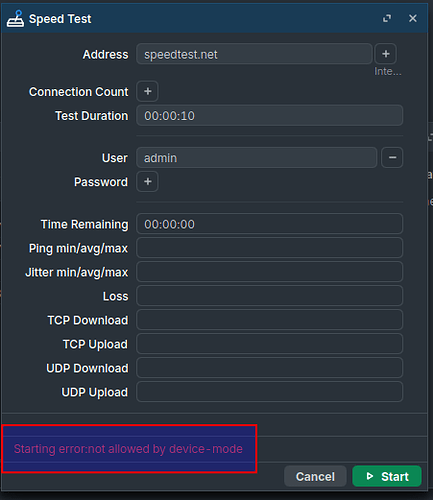

I need to use with "speed test" winbox
There are no official speed test servers in MT's style.
There used to be one hosted by @TomjNorthIdaho but it has been closed as it was overused.
You will also need to change device-mode to be able to run bandwidth test, based no your error above.

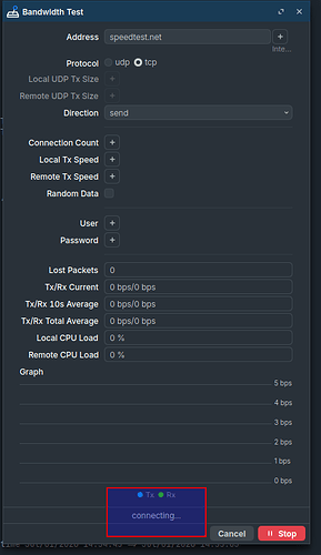

"You will also need to change device-mode to be able to run bandwidth test, based no your error above."
where should I intervene?
with Bandwidth Test remains in "connecting"
I did speedtest, but this is the result. There are no download and upload values: why?

Does speedtest.net have proper service? Does it answer to MT's speed test protocol?
Have you tried to read the manual: Speed Test - RouterOS - MikroTik Documentation ?
MT's Speed test works Mikrotik to Mikrotik.
Nope. But it does measure ping times with any host. You'll note the lack of download/upload speeds in the screenshots. /tool/speed-test both provides an opinionated MikroTik btest client (e.g. it runs several different /tool/bandwidth-test operations as part of one command, with some controls) and provide some functionality of the undocumented V6 /tool/ping-speed into one command.
