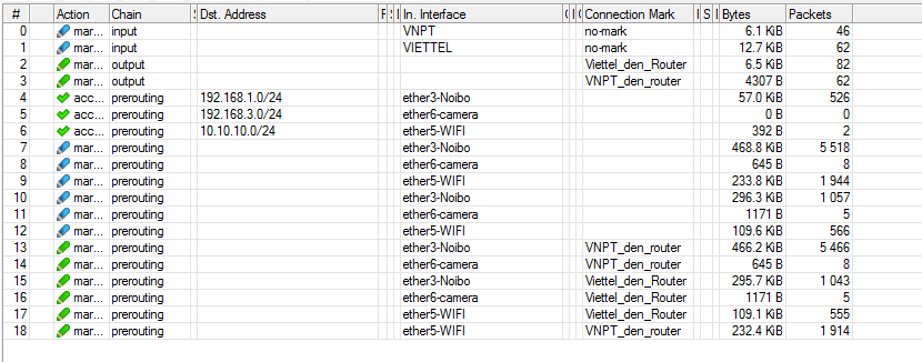

Maybe because i use load balance setting and have mistake on mark routing ? I just disable all mark routing and all ether can see others
