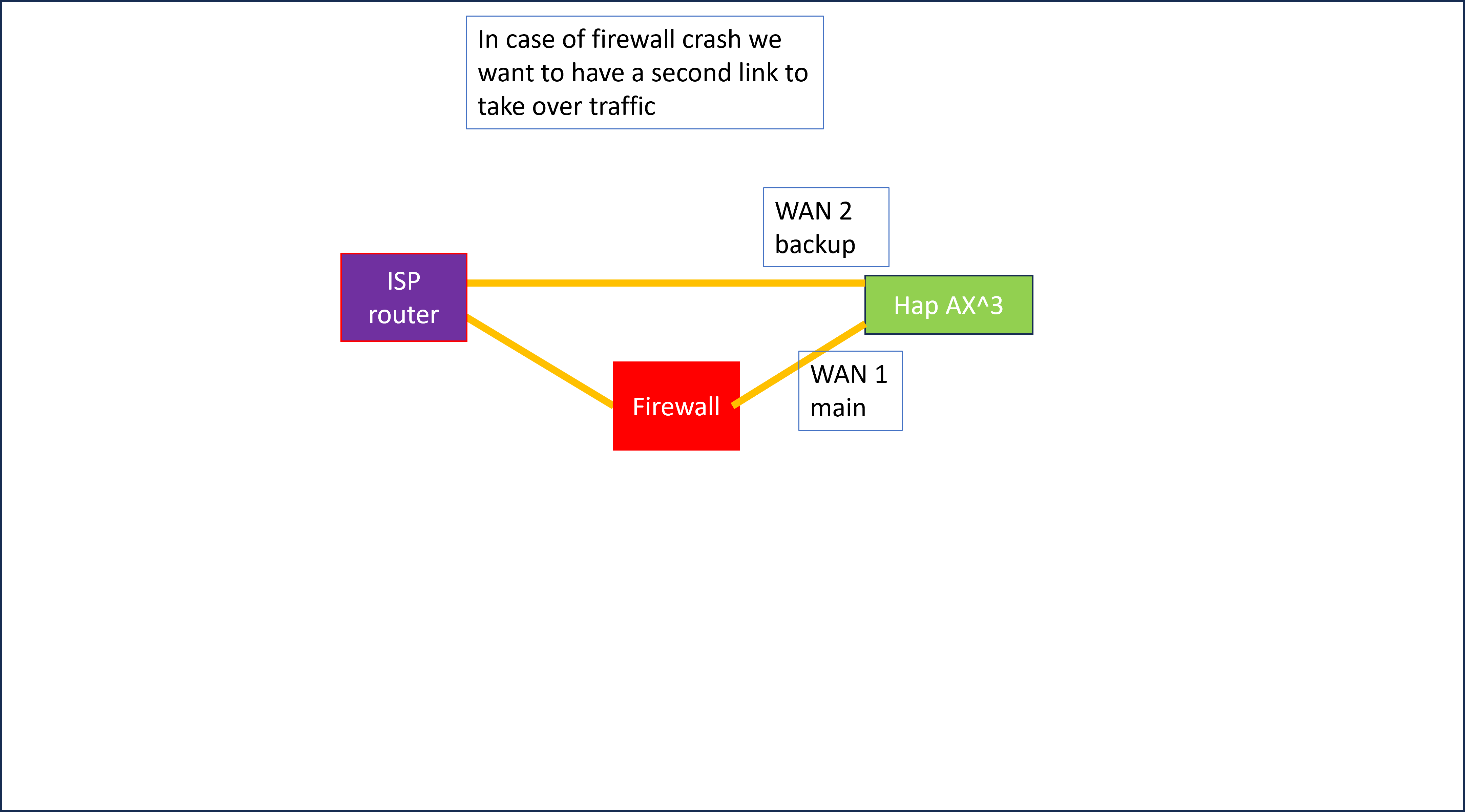

hi,
I wanted to configure my HAP AX3 with a second “WAN” for backup incase my firewall crashes!
I have the HAP AX3 Wan interface 1 as client to my ISP router and the remaining interfaces are on the bridge with the physical ports as well as with VLAN interfaces.
therefore I guess I would need to take the interface 2 off of the bridge to configure as a second backup failover WAN?
I was watching some youtuvbe videos and they all have the WAN Ips as Static? can the WAN IP’s be dynamic DHCP clients?
can you help me with the configuration ?
It shows you skippped drawing class for years … :wink: :laughing:
Yep.

the DHCP server is currently the firewall.
the reason I want to create a second wan link on the router is in case the firewall ceashes.. Therefore I thought of the idea of connecting the Router directly to the ISP router as DHCP client on ethernet port 2 in case of firewall crash!
but thats the question can the “WAN” IP’s be Dynamic or for this failover scenario they need to be set as static requiring the statuc route to the gateways( firewall, isp router)?
