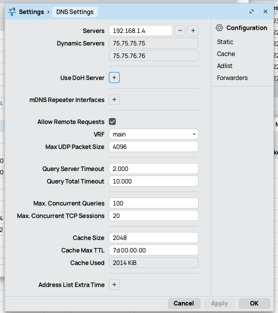

One thing that does bother me though is that the MT shows my ISPs DNS servers in the configuration and I cannot remove them. Is there a way to disable those? In the image below, 192.168.1.4 is my pi-hole DNS instance.

Like I said, the only ones I wish I could eliminate are the “dynamic” ones provided by my ISP with my IP address.
Sure thing, just dont enable them in IP DHCP client.

For both DHCP client and PPPoE client the checkbox to uncheck is Use Peer DNS.
Only if your ISP IPv6 is provided with Router Advertisement (not DHCPv6 client), then at the moment there is no built-in way to suppress the dynamic ISP DNS servers.
Bingo! Thank you. That did the trick.
