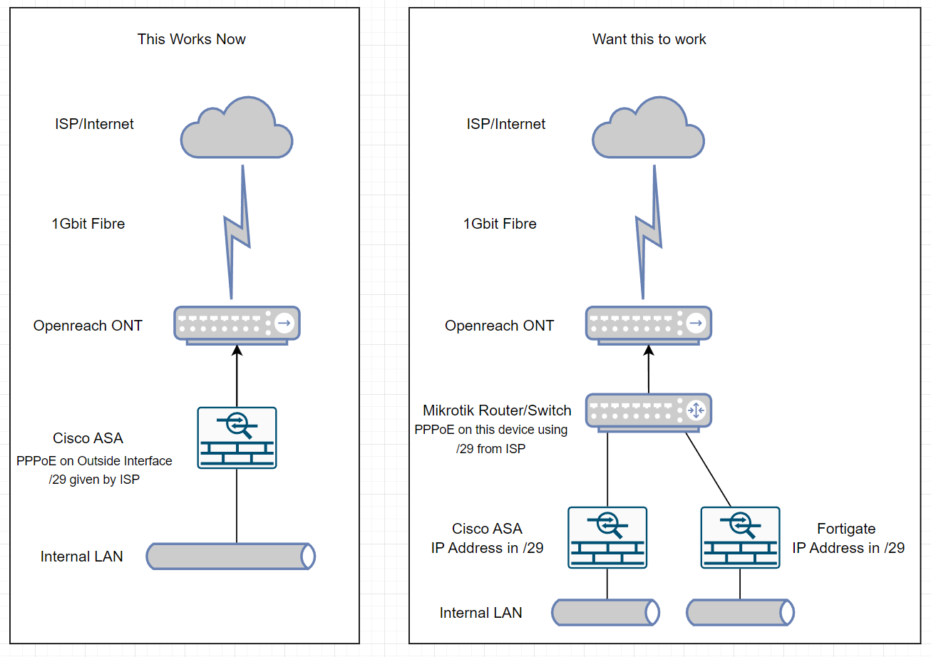

Could one of you please provide a network diagram so I can wrap my head around your problem?
Diagram attached.
PPPoE gives an IP within the /29, the highest in the subnet, with a /32 mask (not /29), and a default gateway of another address in a different subnet. With just the firewall alone, the rest of the addresses in the /29 are usable as NAT addresses on the firewall.
It’s Openeach delivered business grade FTTP from a smaller UK ISP, one of the highly rated ones, not one of the consumer mass market ISPs, if it matters.
I think I now understand your request and I also think that assigning the same address you recieve via the PPPoE to a bridge between the two ports and adding static addresses to the devices afterwards would do the trick. Reference topic:
