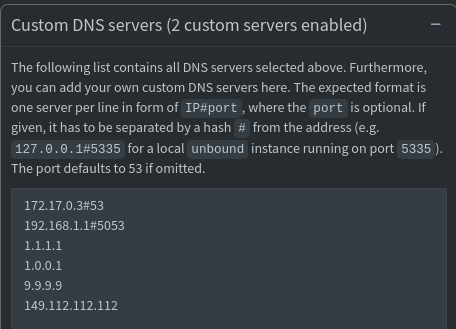

Normally you add a Hairpin-NAT rule to workaround this. But in this case, a much simpler fix is to change the pihole configuration so that it uses 172.17.0.3#53 in the setting instead of 192.168.1.1#5053. It will work and no Hairpin-NAT rule is needed. And the router doesn't need to be the intermediate gateway for this communication between pihole and unbound, improving the performance too.

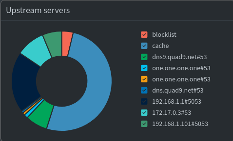

What seems most surprising to me is that with this dns setup of pi-hole
I get these statistics of upstream servers
Which means that a certain amount of dns questions get resolutions with unbound. But not all of them, and noticeably not those coming from my laptop.
