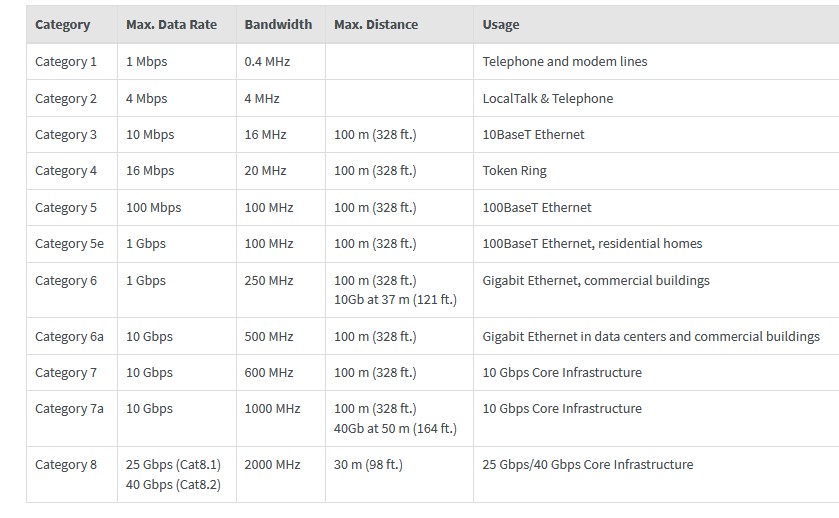

Your previous switch was 1Gbps (if I understand your opening post right) and your CRS304 is 10Gbps. Which is a huge difference when it comes to UTP cable. Even though you’re using a cat7 cable (indicated on your chart), it might be of low quality, it might be improperly terminated, it might be (slightly) damaged (e.g. too tight curves). And if the cable is longer than around half of declared max length (which is 100m/328ft), anything not ideal can affect ability to operate connection at desired speed. Requirements regarding UTP cable for 10Gbps are much higher than for 1Gbps and minor problems might not break 1Gbps connection.
Still, if the ports are set to 10 Gb it should show “no link” (and not “running” status), this kind of “almost connected” (interface running, but not a real communication on it) seems like a tricky issue.

I might have lied with my diagram, but now it is new and fresh cat 7 cable :joy:
The one that was installed was
cat. 6e 28AMG Network Flat Patch Cord CABLE ROHS MADE IN CHINA (30 meters) and it was indeed a bit damaged in one place.
Even if not damaged “flat”, “cat6a” and “30 meters” rarely can work at 10 Gb, personally I wouldn’t use the 28 AWG ones for more than 15-20 meters, maybe the 26 AWG for 30 m, but 23 or 24 are the “normal” ones, good for 100 m.
If I recall correctly good manufacturers give max 60 or 65 m for those and the rule of thumb to be on the safe side Is to not exceed half of the theoretical max.
Still in theory a damaged (but not interrupted) cable should have the devices negotiate a slower connection rate or have a high error rate, but preventing a DHCP lease it is AFAIK unusual.
Maybe the cable was actually damaged with one wire among 4,5,7,8 interrupted i.e. in a way that your previous 1 GB hardware down negotiated to 100 Mb whilst your current 10 Gb hardware cannot negotiate lower than 1 GB (i.e. all 8 wires are needed).
But then It should cause “no link”. :confused:
Seems like 6,6a,7 are perfectly fine for 10gbps connections.
