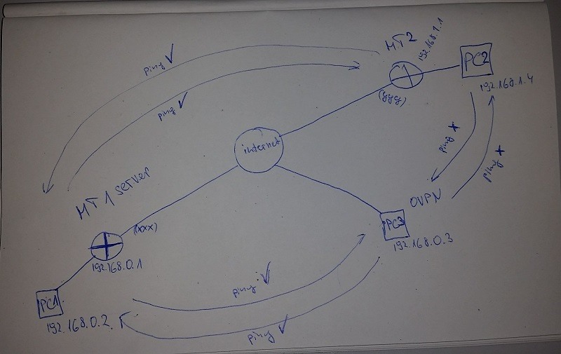

On the Scheme you can see I havent ping between PC2 and PC3!
Can anyone explain how to build this network successfully?
