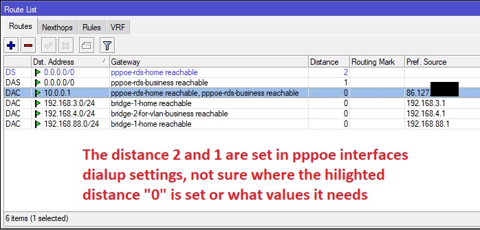

Setting two ISP connections on 2 vlans, same ISP cable
Do you think I can still do this (associate the vlan with certain pppoe) without connection marks and routes based on marks I did in that another setup I mentioned ? If I still need these, then I could do just that without the vlans.
I attached the ip and routes from winbox, but when I exported the config, I do not have any routes or public ips in the text, I think it is because these are all set dynamically and I don’t have set any rules for them.
The pppoe interface (if needed) is this:

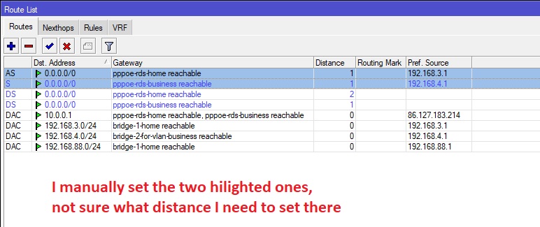

Dear OP. I think you have almost all possible combinations (routing rules, routing marks, bridges, VLAN). All configurations (both posts) can work.
(On the VLAN: study the complex theory in Mikrotik as @anav mentioned (documents the bridge method). Normally you bring all involved ethernet interfaces to the same bridge, if you use the “bridge method”, the other way of doing it is the “switch method”. Methods cannot be mixed). VLAN’s can be of benefit in the WAN (upstream) and LAN (downstream) hybrid connections, where you separate the VLANs later, in a Switch, Router, Server or AP.)
You have the link to this: http://forum.mikrotik.com/t/routing-based-on-source-ip-or-source-interface/111479/1
@bpwl is this what the link recommends (like I added in the image) ?
Not sure what distance to set there in my case.
Okay adrian, you can relax, it all makes sense…
If you look at your routes, one is distance1 and the other is distance 2
The default for both is one, but you entered 2 I believe for rds-home and thats why rds-work is reachable and BLACK font (being used as Main table route).
while rds-home is reachable and BLUE FONT (not being used)

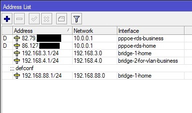

It also shows you the DAC line of the network the active route is using 10.0.0.1 via rds-business and the preferred source (the IP of the rds-work)
What this means is that all traffic will go out rds work at the moment as expected due to your setup (having the shorter distance)

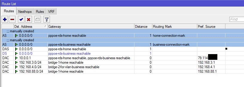

Now we want to move to a slightly different model… and forget adding preferred source, not the way to do it!
First step is to change the pppe client setting for distance to be 1 for the rds-home so both are equal.
Then I would create copies of the two existing routes.
Add comment to each copy so you can tell one from the original (Directing Home Users, and Directing Work Devices for example)
For the Directing home users
destination address = 0.0.0.0/0 gateway= pppoe-rds-home distance=1 Routing Mark=4_home
For the Directing work devices
destination address = 0.0.0.0/0 gateway = pppoe-rds-work distance=1 Routing Mark = 4_work

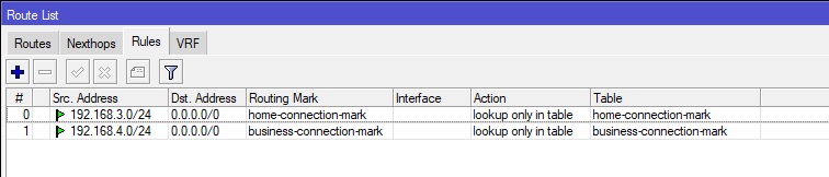

Now create two Route Rules
For Directing home users
source address = 192.168.3.0/24
Table= 4_home
Action= lookup in table
For Direction work devices
source address = 192.168.4.0/24
Table = 4_work
Action = lookup in table.
The result will be that the appropriate group of users will go out the table assigned.
Alternatively in the Route Rules you could use the bridge interface,
aka use INTERFACE vice SOURCE ADDRESS ( bridgehome, bridgework )

Still missing the ISP2 routing table, with ISP2 distance =1 (and if you want failover ISP1 distance=2)
Main routing table with ISP1 distance=1 and ISP2 distance=2 is OK
Remark: you can change the distance of the DHCP-client inherited default routes to a higher distance in the DHCP-client setting
"Then make a static default GW route with dst=pppoe2 as the main route (lowest distance value) and optionally a second one with pppoe1 as a backup default GW (higher admin distance value) for the "isp2" routing table. (routing-mark=isp2)
Once those exist, you can make a route rule which says if the source IP is from lan2, then action=lookup-only-in-table table=isp2"

So I added the two routes and created two rules (this is under routes window > rules, correct ?!)
With the attached setup, both 192.168.3.x computers and 192.168.4.x computers seem to use the “home” connection.
I tried setting the interface under rules, associating with each of the two bridges, but I didn’t see a difference.
Any ideas ? Maybe the value after action “lookup only in table” is wrong ? Do I select the mark name after that ? Or “main” ?
First thing, one should use look up in table vice look up ONLY in table, because then if one ISP is offline the other one will not be used for traffic.

Dont worry about the route rules, the ones you have are fine,

What is wrong is that on an /ip route rule row, routing-mark is a match field, whereas table is an output parameter to be set if all the match fields match.
routing-mark and routing table name are almost synonyms everywhere else in the configuration, but not here, as the /ip route rule rows can be used to translate one routing-mark (which has been assigned by vrf or by a mangle rule) to another one (specified in the table column).
So you rules never match, because nothing before them assigns any routing-mark to the packets. Just make the routing-mark column empty in both rules and keep the rest as you’ve shown, and it should start doing what you want.
The interface column matches on in-interface; since you match on src-address, there’s no need to match also on interface in this simple setup.
If I understand correctly it is like seeing a box named “routing mark” and is confusion because it doesn’t say “routing mark to set” or “routing mark to match”. Did I get this right ? I noticed this problem with the interface and it makes it a pain for beginners to set things up.
Edit: I tried clearing the values under routing-mark column in rules window, rest is as in above image. It didn’t change anything and set it back as in image above.

No you need to follow directions properly.
As sindy astutely pointed out (he has four eyes while us mere mortals have two!!.
You added the extra routing mark entry in the route rule…
READ MY INSTRUCTIONS AGAIN!!!
Table= 4_home
Table = 4_work
Does it say anywhere to add a routing mark entry LOL.
Simply remove those and it will work.

Remove the routing-mark values from the rules again, and once you do that, post the proper text export of the configuration rather than the screenshots.
it works now, after removing the routing marks you two mentioned :smiley: Thanks !

By means of the rules, you choose a dedicated routing table for each source subnet. So one possibility is to add a backup default route via “Telekom” to both routing tables, home-connection-mark as well as work-connection-mark, with distance=2. Another possibility is to change the action=lookup-only-in-table in the rules to just action=lookup, which means that if no matching active route can be found in the routing table indicated, a matching route in routing table main is used. And the DHCP client adds the route to routing table main.
None of the ways above provides a backup against a problem at ISP side, where the PPPoE connection is OK but ISP’s own connection to internet is broken, as in such a situation, the primary route via PPPoE stays active, so the backup one is not used. To eliminate this, you need a more advanced setup (but you still don’t need mangle rules :wink: ).
The fact that the primary routes are PPPoE ones complicates that setup a bit. Too late here, won’t say more today.
Nice, that worked, adding a “distance 2” route for my Telekom backup ISP, and changed the existent rules from “lookup only in tables” to “lookup”.
It now switches to my backup isp if the other two fail.
Thanks !
I will search a bit to see what “lookup” vs “lookup only in tables” does.
As I explained, LOOKUP tells the router for the source address traffic or interface identified, to use the table identified in the route rule instead of the main table.
If the table being pointed too is not available, lets say the ISP is offline, then the router will revert to the next available route in the main table for that traffic (with source address or interface).
LOOKUP ONLY in table is a stronger command in the sense that EVEN IF the ISP is down, the router will NOT revert to the main table to look for a reachable route to pass the traffic.
In other words, there is no backup potential, use only this table and nothing else.
