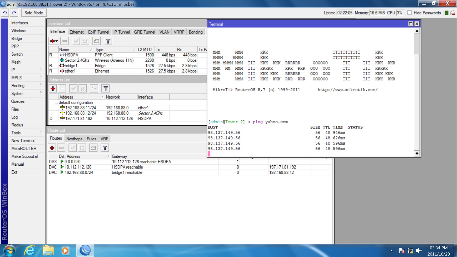

I have a RB411u with a ZTE MF190 modem connected via usb, the modem does connect to the internet (See pic) as I am able to ping Yahoo.com.
But I can’t connect to the web via my pc ……
You need to start a new topic, and not hijack this one… but it looks like you probably didn’t setup NAT Masquerade. Don’t forget to setup nat-masquerade and dns if you want pc’s to connect to Internet through your router with a single public IP address!!!
