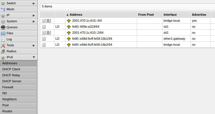

IPv6 - Addresses

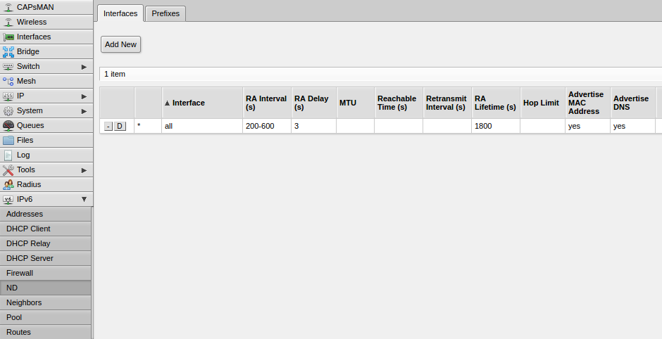

IPv6 - Neighbour Discovery - Interfaces

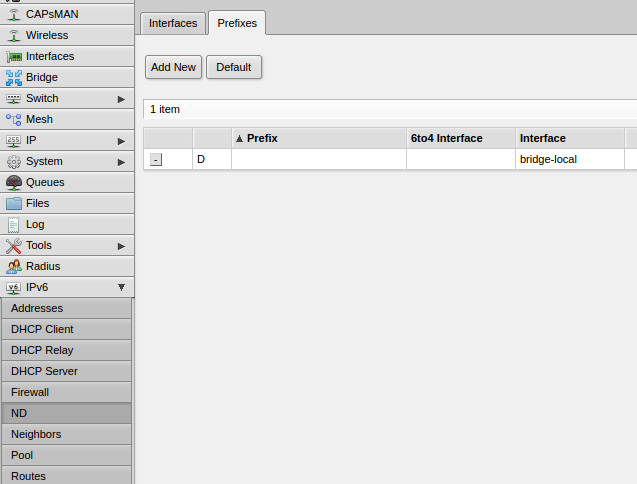

IPv6 - Neighbour Discovery - Prefixes

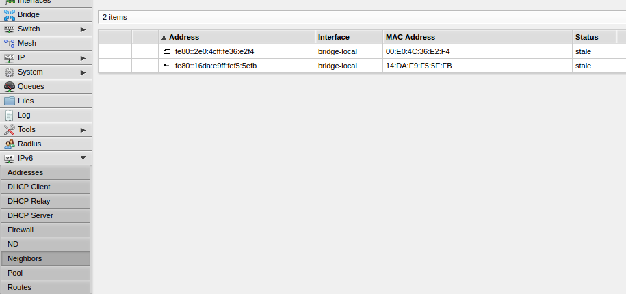

IPv6 - Neighbours

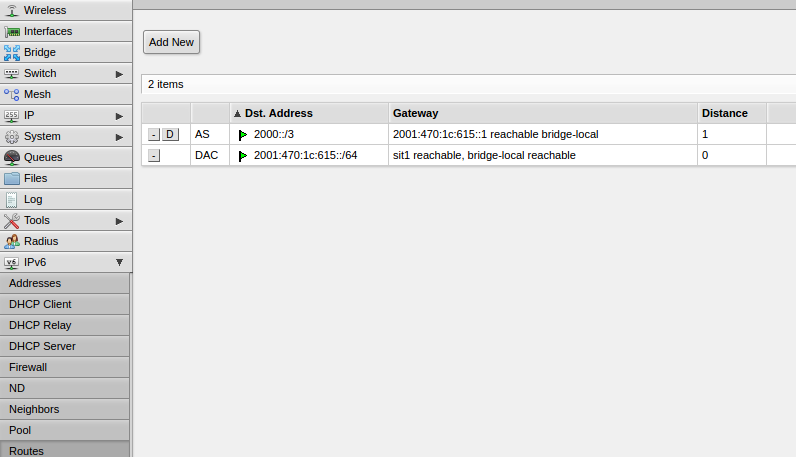

IPv6 - Routes

You have same /64 subnet on both sit1 and bridge-local. It should be two different ones, look closely at what they gave you.
Thanks so much! It was obvious when you pointed it out. This is why the third block in the prefix is in bold in the TunnelBroker configuration and in the wiki (duh). I with that they called it out explicitly in the text so that people don’t make the same mistake that I did!
