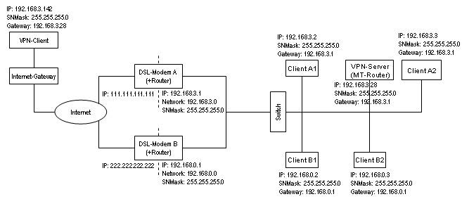

I set up a route for “0.0.0.0/0” to the LAN-ip-address of the dsl-router (192.168.3.1/24). Everything’s fine so far.
Now I have the problem that ARP doesn’t work properly.
If I set up an ARP-entry on a windows client by hand:
arp -s [LAN-IP of the VPN-Client] [MAC-Address of the VPN-Server]
the windows client can talk to the vpn-client (and vice versa).
I tried to create a bridge on the vpn-port of the MT-Router (with option “proxy-arp”) but then the whole network (two subnets) broke down because the MT-Router answered on each and every arp-broadcast-request with its own MAC-Address.
How do I have to configure the Router to handle arp requests correctly? (It may only answer arp-requests that are designated to go through the vpn-tunnel and ignore arp-requests from the other subnet B)
I added a picture with the network topology

Hi neyman.
What you describe is what I’ve done. My VPN is established correctly (authentication is ok and the tunnel is up). But if a LAN-member “A” from one side of the Tunnel wants to speak to the VPN-Client on the other side, no data is transmitted because arp-requests are not answered so that they don’t know their MAC-addresses. (The MT-Router should tell the LAN-member that the VPN-Client is behind the MAC-Address of the MT-Router)
I could set the interface the exposed LAN is connected to in proxy-arp mode but then my MT-Router answeres to each broadcast ARP-Request with it’s own MAC-Address. Then “A” can speak to the VPN-Client but the second subnet brakes down after a while because the MT-Router answeres every arp-request with the router’s MAC-Address although there is no ip-route from the MT-Router to the other subnet.
I think I have to set up the MT-Router to just answer arp-requests from within the exposed LAN. Maybe I have to set up a filter rule but I don’t know how to do that.
Regards Thomas
try to set proxy-arp insted of default or enabled on interface
That’s what I tried. But the MT-Router then not only answers arp-requests out of the vpn-exposed subnet (192.168.3.0/24) but also answers the arp-broadcast-requests from another subnet connected to the same ethernet port of the MT-Router (on the same wire there are also arp-broadcast-packages from a 192.168.0.0/24 network, see attachment above).
Answering these “foreign” arp-broadcast-requests is bringing the 192.168.0.0/24 network down after a while! :frowning:
I tried to set up a bridge on the ethernet port, setting it in proxy-arp mode and define some filter rules. I want the mikrotik-router drop every arp-package coming from the “foreign” subnet but I could not create a working ruleset until today (I’m beginner in defining chains, iptables, etc…).
Any suggestions would be appreciated.
Regards, Thomas
Ok, I tried the following ruleset on my bridge on ethernet port 1:
0 chain=input mac-protocol=arp arp-src-address=192.168.3.0/24 action=accept
1 chain=input mac-protocol=ip action=accept
2 chain=input action=drop
I set the arp mode of the bridge to “proxy-arp”. It seems to work now but it would be nice if somebody could take a look whether these rules can produce a bad side effect.
Regards, Thomas
