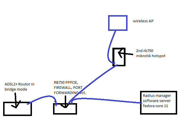

I have attached a diagram of a basic WISP configuration.
i don’t use the proxy cache.
the caps and the plans are controlled by the radius server (radius manager) configured through a web browser. you can attach wireless repeaters. bandwidth is also controlled by the radius server.
Hope this helps.
Cheers Paul

do you need the hotspot if you have the raduis server?
I believe hotspot uses radius for authentication. I’m working on redesigning a medium sized wisp, transitioning to mikrotik (1000+ subs), and I’m opting to use the User Manager package over a radius server. Easier for me, there are pros and cons I’m sure.
