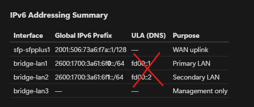

IPv6 Addressing Summary
Interface Global IPv6 Prefix ULA (DNS) Purpose
sfp-sfpplus1 2001:506:73a6:f7a::1/128 WAN uplink
bridge-lan1 2600:1700:3a61:6f0::/64 fd00::1 Primary LAN
bridge-lan2 2600:1700:3a61:6f1::/64 fd00::2 Secondary LAN
bridge-lan3 Management only

The AI has generated a lengthy post with a lot of redundancies, but as usual with things involving AI and RouterOS, produces some really dumb parts too:
  • You don't need this:
    Because it produced two totally unneeded ECMP routes in your routing table.
  • What you should do is to go to https://www.unique-local-ipv6.com/, copy the random prefix presented to you (for example fdba:ed6f:78cf::/48) and use it to put a single IPv6 address on the lo interface:
    /ipv6 address
    add address=fdba:ed6f:78cf::1/128 advertise=no interface=lo
  • Then in the /ipv6 nd entries, just put that same single fdba:ed6f:78cf::1 as DNS server, you can even keep the one entry for all and put it there. No need for individual DNS addresses for each of your two bridges.
Really good feedback @CGGXANNX . I have updated my system and config it works as you recommend ! I agree that the additional ECMP routes are unnecessarily complex, and lo solution is far better.
Attached is tighter documentation which covers the implementation, shout if you think it still needs to be adjusted.

A nice addition might be to show how when you use dig to verify the lookups are working, the first time might show something like Query time: 26ms to resolve, and if you repeat the same lookup a second time, it will show more like 1ms, thanks to it being cached.
Sure, easily done !
I did this when I was testing but forgot to include it in the instructions for the next person. I recommend testing the A records (IPV4) AND the AAAA (IPV6) records because the DNS at either IPV4 or IPV6 addresses will service BOTH. This is potentially confusing if you are expecting the IPV6 DNS provider to ONLY reply with AAAA records (it does both), or if you are expecting the IPV4 DNS nameserver to provide only IPV4 addresses (it does both!).
If you find you are missing dig, and are on MacOS, use brew ( https://brew.sh/) and install : brew install bind
