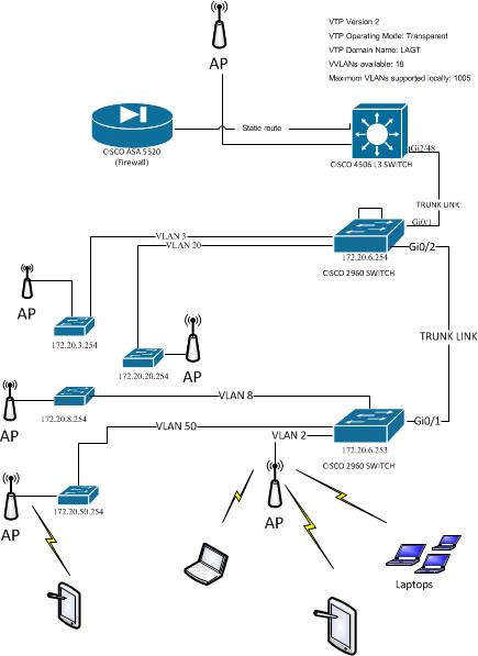

my network has over 25 vlans via cisco router with a separate DHCP server for ip lease.
i have user on both wired and wireless across all the vlans.
issue how do i integrate the hotspot and radius feature over only the wireless AP (ubiquity) all across the vlans on the network.

thanks for the prompt response. however, do you mean that i have to setup a mikrotik hotspot for every vlan on my network each?
with the attached illustration of my network, i want to know if and how i can setup an hotspot at a single point on the network and require only end users connecting on wireless via the Access point (UBNT AP) to authenticate across all the vlans on the network.
thanks
You could put all of the vlans on the
Mikrotik then bridge them together and run the hotspot on that bridge interface.
