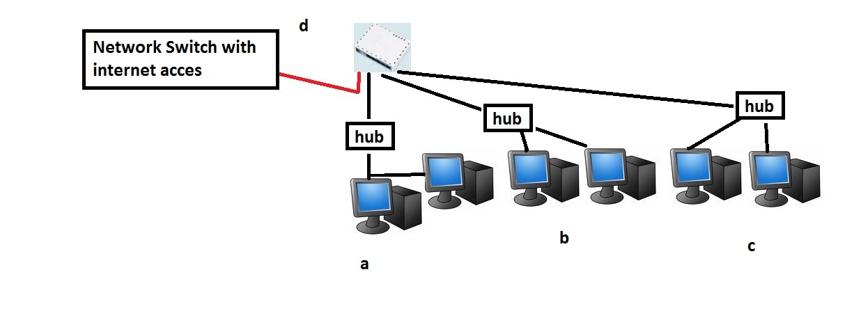

Attached is a simple network diagram of what i want to do.
basicaly i want to give 3 different offices with in my building different ip ranges?
This is so i can watch the clients who are renting the rooms internet usage?
So your configuration on the RB750 is like:
/ip addr
ether1 = 192.168.0.2/24
ether2 = 192.168.1.1/24
ether3 = 192.168.2.1/24
ether4 = 192.168.3.1/24
0.0.0.0/0 over 192.168.0.1
And now you want a client e.g. 192.168.1.129 to show up as 192.168.1.1 and so on?
While I don’t really understand why you want to do this, this is possible doing NAT:
/ip fire nat
add chain=srcnat in-int=ether2 out-int=ether1 action=src-nat to-addr=192.168.1.1
and so on...
BUT it requires your main gateway to have a route back to 192.168.0.0/16 over 192.168.0.2
