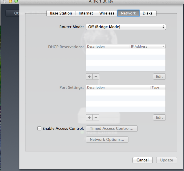

I am not sure of the answer to the upside of double NAT. I wanted to be able access a Apple computer and an Apple TV via the Apple Extreme’s Through VNC, as well as wake the computer from sleep. Here is my interface.

You don’t need to have it setup as a double NAT for that.
Basically what you can do is utilize the Airport Extreme as a WIFI access point, but use the MikroTik as the Router/DHCP/etc… Thats what I am currently running…
Then you just forward whatever ports through that you need for VNC, etc.. through the MikroTik… and just use the Airport for wireless. I personally would not do double nat.
I understand what you are trying to do… post your export and explain what parts you are stuck on and I can help you.

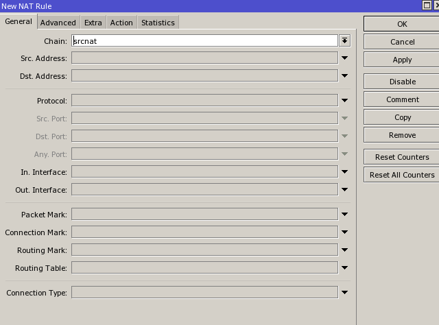

Okay, I know I need to set the Apple Extreme (AE) has to connect using DHCP-NAT for the Back To My Mac feature to work, which I believe uses port 5900…I’ll reconfirm. Then, I know that I need to to Microtik’s IP>Firewall >NAT, and set new rule…and that’s where I am. AE is below that.

You can either use UPnP which Back to My Mac seems to support or use a dst-nat rule to forward it. Something like
add chain=dstnat dst-address=<PUBLIC IP> protocol=tcp dst-port=80 \
  action=dst-nat to-address=<INTERNAL IP>
