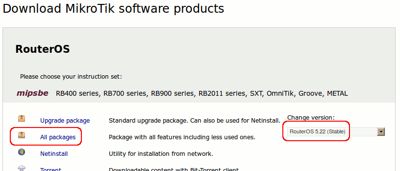

  1. You need to download the All Packages files that has the same version as your router from http://www.mikrotik.com/download
  2. Extract the user-manager…npk file from the .zip archive.

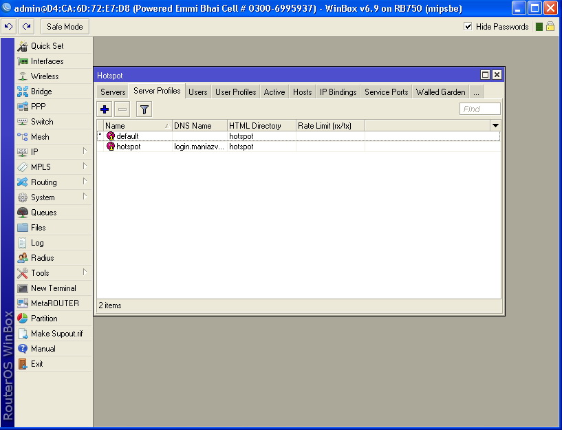

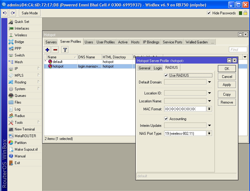

hi,
go to ip, hotspot , server profile select you hotspot server, tick us raduis
now move to radius (ln main Menu ) set ip 127.0.0.1
ref attached snaps
look at these screen shots.
everything seems to be in order

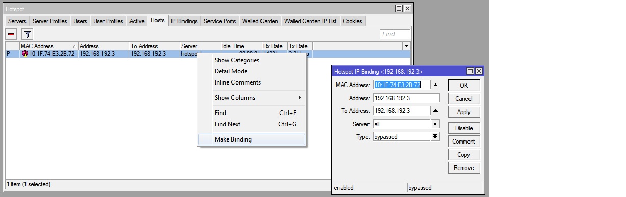

try to bypass you ip from hotspot and check you userman access
how do i do that please?
http://wiki.mikrotik.com/wiki/Manual:IP/Hotspot#IP_Bindings
Read about ‘type=bypassed’.
HTH,
snap attached
thanks very much. I did it yesterday and since then i’ve had usermanager working.

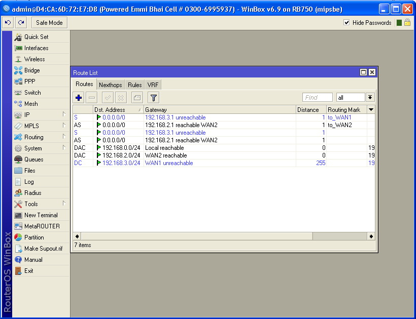

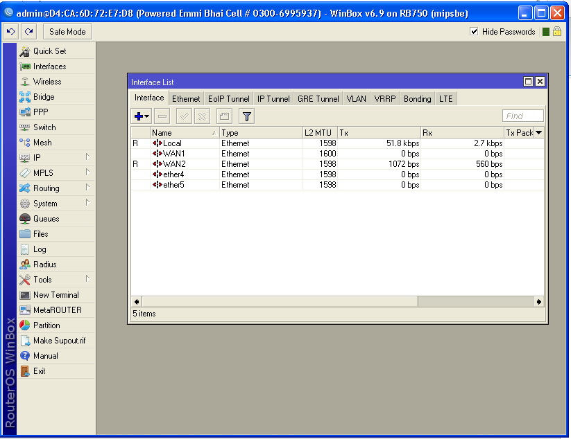

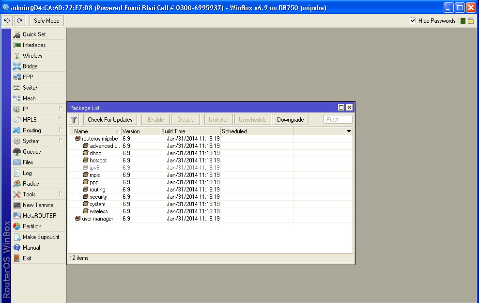

This is my Mikrotik Router Board Configuration and I am still unable to access the user manager page via web browser via the 192.168.0.1/userman and also unable to do IP Binding to bypass the login page.
Can you please guide me where my settings go wrong. I will be highly thankful to you.
