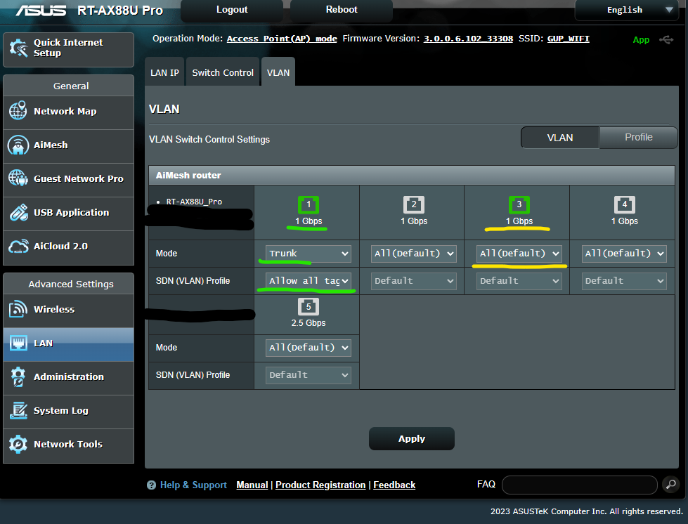

All of that is good news, but I still do not fully understand how VLAN works on AX88UPro. I’ll post the questions/issues that I have once I get a chance to take some screenshots.
This is the config on the AX88UPro:
Issue #1: I had defined an SSID under the “Wireless” section (first screenshot red highlight) named GUP_WIFI. This SSID appears to NOT be tagged at all and thus does not work via the LAN1 trunk port. That is expected, but… how to I add a VLAN tag to that one? I wanted to make that the “Home” VLAN (VID = 10). But I do not see how. I added a VLAN Profile for VLAN VID = 10, but I do not see a way to “map” it to the wireless network definition under Wireless (the GUP_WIFI SSID).
I think I might need to define all VLAN SSIDs via the “Guest Network Pro” interface/page and remove the one on the Wireless interface/page.
This is still not ideal because the WiFi password you can define under “Guest Network Pro” interface/page is buggy. It removes spaces and restricts the length to a much shorter string. I do not know why. Seems wrong and buggy.
Issue #2: Understanding the terminology ASUS uses.
“Guest Network Pro” interface/page has a page filename of SDN.asp
LAN → VLAN has a page filename of Advanced_VLAN_Switch_Content.asp
LAN → VLAN - Profile has a page filename of Advanced_VLAN_Profile_Content.asp
The only page that seems to be fairly clear is Advanced_VLAN_Switch_Content.asp. It is simple, yet limited.
SDN.asp and Advanced_VLAN_Profile_Content.asp seem to overlap and be somewhat redundant. It is also limited in what you can see and define.
I am still considering switch off the ASUS and into an AP with proper VLAN support. The ASUS is still tempting because (1) it is supposed to be a good AX/WIFI6 router (4x4) overall, (2) ASUS seems to be adding VLAN support, albeit buggy and limited, (3) I already have the device, (4) I have uses AC68U for a while and “know” the interface, and (5) they are relatively cheap if I want to get another one of the same.
Since this is mikrotik forum, I am doubtful I will get answers on the ASUS questions, so I will need to cross-post those into some ASUS support forum.

I tried assigning /interface bridge port ether4 vid=99, but that does not work either. I get locked out of the router.
There is another managed switch (MokerLink 2G04210GSMX for eventual PoE for APs) in between .3 (hAP ax2) and .4 (hAP ax3) via trunk port sfp-sfpplus1. The wireless networks on the ax2 and ax3 work fine via the trunk port (DHCP, internet, etc.). But I just cannot ping or access 10.99.99.3 or 10.99.99.4 via PC connected to ether4, which is supposed to be access port for vlan99.
I am sure this is user error. I just cannot pinpoint where I messed up the configuration.
I think under /interface bridge port you need to set pvid of port ether4 to 99 (instead of the default value of 1). That port will then be an access port for VLAN ID 99. While you are there, also set frame-types=admit-only-untagged-and-priority-tagged for that port.
It’s not enough to set “untagged=ether4” for the “vlan-ids=99” under /interface bridge vlan. In fact, if you already set pvid of ether4 to 99, you aren’t required to put “untagged=ether4” for that entry.
Also under /ip dhcp-server network there is no corresponding entry for the MGMT-vlan 99 network (10.99.99.0/24)?
Thanks CGGXANNX.
I had tried setting /interface bridge port pvid of port ether4 to 99. But it did not work; specifically, I did not get an IP address at all. I was indeed missing the /ip dhcp-server network entry for the MGMT vlan network of 10.99.99.0/24. I had looked around DHCP settings, but did not notice that.
I now get an IP on 10.99.99.0/24 network when I connect to ether4 port.
But I still cannot access other hosts in that MGMT network. Specifically, there is another MikroTik device with IP 10.99.99.4 which I cannot reach from either the PC on ether4 nor the RB5009 router itself.
UPDATE: Once again, having more than 1 cable plugged into a device caused issues. I have been doing this as a way to continue to access devices that will ultimately be managed via the MGMT vlan from “vlan 1”. This appears to create problems, perhaps because packets would not be sent to the correct port? In this case, I had a cable from an unmanaged switch that went into the RB5009 ether6 port which is currently Untagged vlan 1. That was going into the MokerLink between the RB5009 and the MikroTik device with IP 10.99.99.4. As soon as I unplugged that connection, all worked via MGMT vlan access port (ether4 on RB5009)! I am sure this is a noob mistake. I was only doing that because I did not have MGMT vlan working as intended. Now that I have, I no longer need to use these “extra cable connections” and hopefully avoid this type of issue in the future.
Do you have a reworked network diagram with your second version of the configuration shared or might you possibly have a new config/diagram you can share? I’m pretty sure the weeks I’ve spent searching “RB5009 and non-mikrotik access points” is about to pay off…I may have questions however I’d like to try and solve myself - thanks Mikrochad and thread-commiters, thank you.
