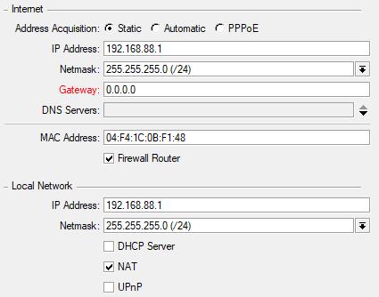

This config works on ether2. Adding ether1 to bridge seems to work but the Quick Set screen IP area seems unhappy assuming that red stuff denotes unhappiness. I have included a config file as well as a screen shot of the red field.

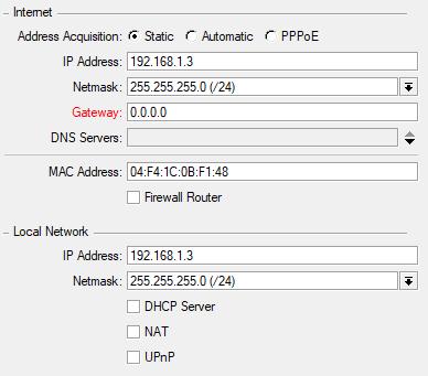

I changed the rsc per the above and it works though WinBox is still unhappy about the lack of a gateway IP. That caused me to have to find another way to enter the wifi password because APPLY would barf. Is there some way to fix that?

This is what I mean by unhappy. When I tried to change the network name or wifi password (also located on that page) it flags the missing gateway as an error and won’t save anything.
How (EXACTLY) do you get to that Winbox dialog?
Not through Quickset, I hope.

Apparently I violated one of the rules. That dialog is in Quickset.
I did find out how to change those parameters elsewhere but I always get nervous about red fields and error warnings.
Yep, Quickset is prominent in winbox as it is first item, so it is very easy to think that it should be used, and used often.
It actually can be used (and actually works usually fine if you want EXACTLY one of the available configuration templates) BUT ONLY ONCE and ONLY AFTER a device reset to default, what it produces when used over an already modified configuration can be as well good in some cases, but in most it just corrupts the existing configuration changing, adding or removing settings that should be left alone.
Thanks. Seems to be behaving nicely now.
