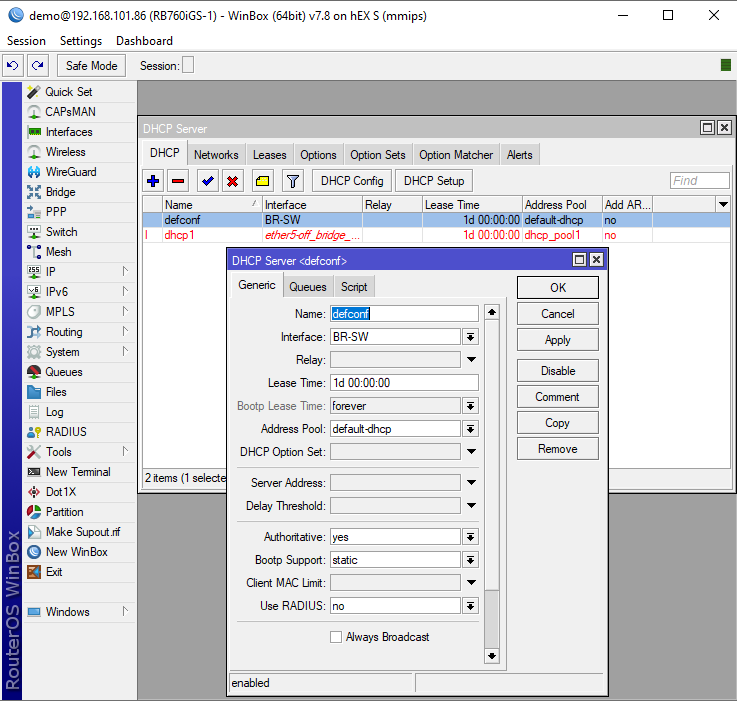

I will be surprised if this makes a difference, but you could try forcing the dhcp server to always use broadcasts. That’s generally not the best, but in a small network you probably won’t notice a difference. There are some devices that periodically poll to verify that devices are still there, and these normally use unicast, which is a better network citizen. And it may not work with some other devices, (so it is possible that it could fix one problem, but cause another). For example see this old thread DHCP - Lease - Option “Always Broadcast”, what is the purpose?. In v7.8 on my hEX S the checkbox is at the bottom in WinBox.
add address-pool=default-dhcp always-broadcast=yes client-mac-limit=0
interface=BR-SW lease-time=1d name=defconf
There is also a checkbox at the bottom of the ip dhcp server window in WinBox (if you can figure out how to get to the screen).

That was my lab router, not the OPs. And there isn’t anything connected to ether5 at the moment.
I was just showing the OP where the “Always Broadcast” was in newer versions of WinBox/ROS than the picture in the link to another thread I posted.
