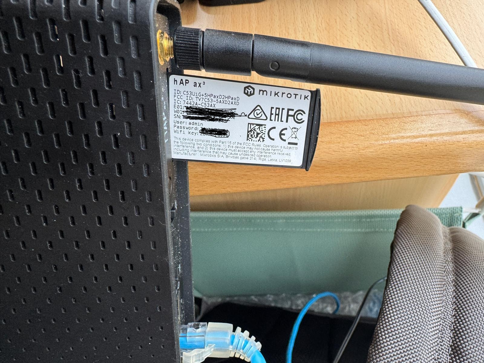

Did you find the label of password in the device? username is admin
I think new device password is no longer blank but with a special tag or label on the device. In my AX3, it is a retrievable tag
