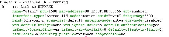

i’m posting the wireless setup, I do not know what part of the radio setup do you want?
