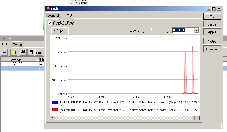

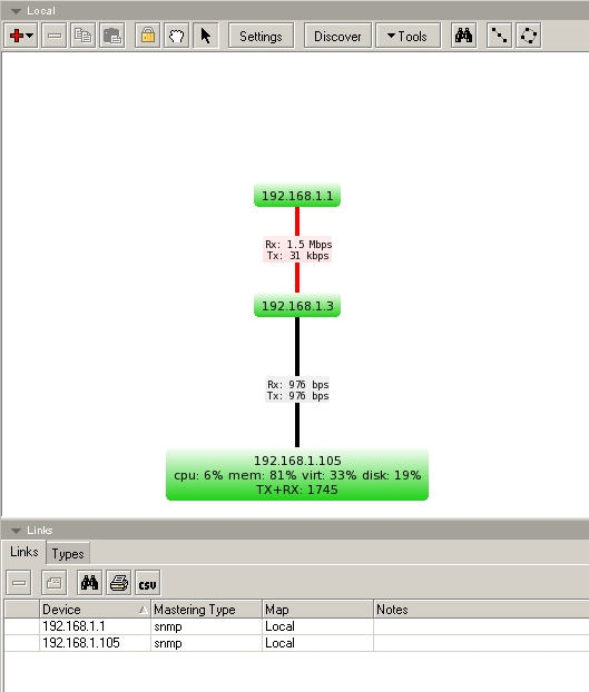

Add the devices to a map and create a link between them. The link that you then created should appear in the Link list. like I have below…
Double click on a link in the link list and click on the graph tab and you should see the graph…
