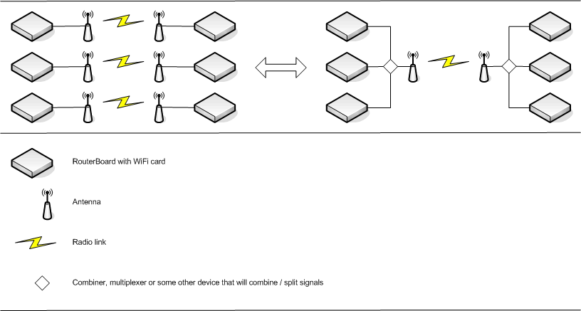

So, let’s start. The goal is to connect 2 geographical points with a link that has a good scalability, meaning, we can add bandwidth easily, when needed.
The first thing that comes to mind is to setup several parallel links, each one using a different radio channel. But, in order to reduce the need for new antennas, we can try to combine all those radio links and transmit them over one pair of antennas. Ideally we could achieve N links over 1 communication channel, without any loss, thus avoiding expenses of mounting new antennas on windy towers, whenever we want to add a new link.
I’ve realized by now there are several devices that can be used in this scenario as combiners of radio links (like diplexers, triplexers, multiplexers, combiners, splitters, etc.). Their purpose is to utilyze a single pair of antennas to transcieve several logical radio links (using different radio frequencies). As I research further more, I also realize that so many times announced 802.11n standard supports MIMO (Multi Input Multi Output), which basically uses antenna arrays to achieve many-to-many links (correct me if I’m wrong).
Another approach to this is using a dual polarity dishes (antennas). Shortly, these kind of antennas have 2 heads that can transcieve 2 radio links over 1 pair of those antennas, without the need to use any of those combiners. However, our goal is to establish several links (as much as we can) to utilize 1 physical pair of antennas, so, even suggestions that involve using dual polarity antennas are welcome in this discussion.

The “combiner” costs more than two additional antennas + time to mount them.
Use a dual polarized antenna for having two links on one antenna. That’s the best you can do at a reasonable cost.

Very interesting, however putting more then one signal on an antenna from multiple radios will in effect create enormous amounts of ‘noise’ for the other radios. The 802.11 radios do not filter out of band iterferance very well (try setting up a pair of links and set the frequencies 20 Mhz apart, then run speed tests on the links individually and simultaneously). You would most certainly have to use bandpass filters after the radio and prior to the combiner. This would add even more cost to the setup, and while I believe it would work, this type of thing would really only be needed if space was at an absolute premium, and you really had to use 802.11. Alternatively, with all the extra costs you could buy a ‘premium’ radio system capable of higher speeds across the single antenna thus using the spectrum more efficiently.

Seems like you are solving the wrong problem. Dont worry about combining RF, it wont work because of previous comments regarding noise.
If you need to get 3 independent streams of data between 3 pairs of radios, solve it with RouterOS.
Connect the two ‘localities’, if this is the scenario, with a backhaul such as 2 R5H based radios on a 411 for example.
Of course you must collect the 3 streams from each ‘locality’ by using an AP to allow them to connect to the backhaul location.
Final step. Create end-to-end tunnel of your choice. Use tunnelling as the ‘combiner/duplexer’…
Since the ‘combined’ RF would take the same path as the ‘tunneled’ streams, addition of two APs should solve the problem unless geography or topology precludes connection of all nodes on each end.
