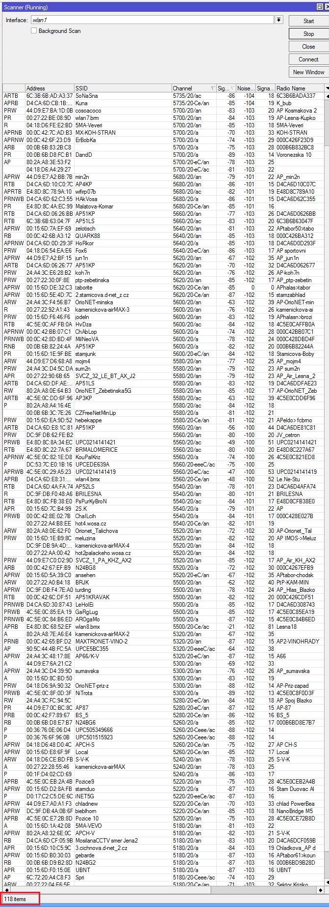

Sure it works at village … but not in cities. You probabaly have not such site survey (and this is not complete yet ! )

Unfortunatelly there are some places in the middle of the big houses (in Prague) where I can scan 50 ssids on hap lite (2G band!). Looks like UPC does not care at all about their “super powerful modems” that they provide to the customers… Five bars - the best internet ever…
