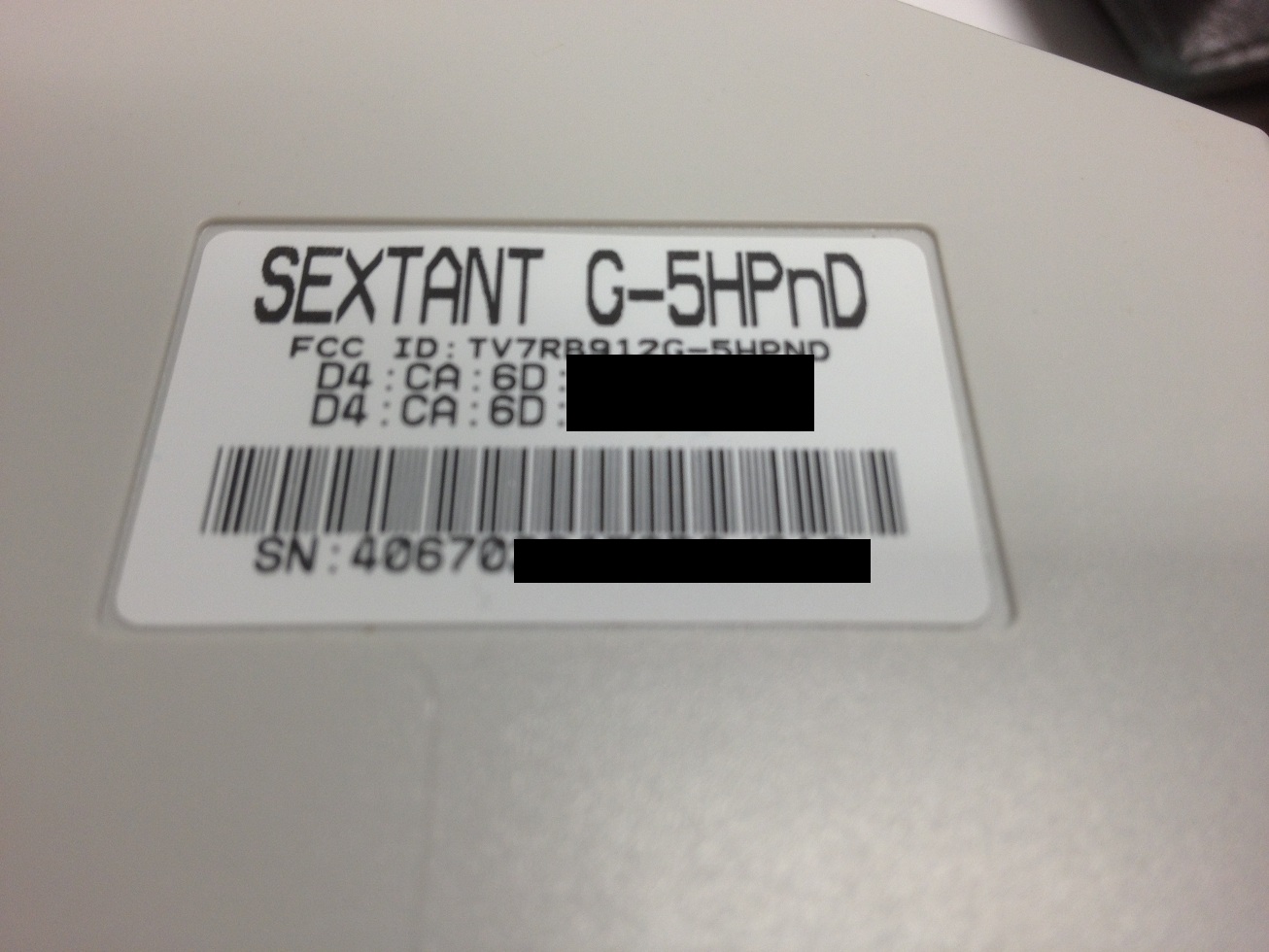

Sextant, can't get port to link in Gigabit. G-5HPnD
Am I correct in assuming the Sextant G-5HPnD has a gigabit port?
I had the understanding that this unit had gigabit Ethernet. I cannot get it to link at Gigabit speeds.
I am using the stock PoE adapter. Bench setup, Cat6, Cat5E, connecting to RB-250GS, computer, gigabit switch, etc.
I’ve tried locking to gigabit speeds, auto negotiation, crossover cables, etc.
Nothing.
Am I mistaken? Or is there a trick to this?
FW is 5.25 and RB firmware is at latest level.

Is it really a SEXTANT G? We also have non-G SEXTANT models.
Perhaps I can’t read properly?
Please see/attach this to Ticket#2013102266000748
