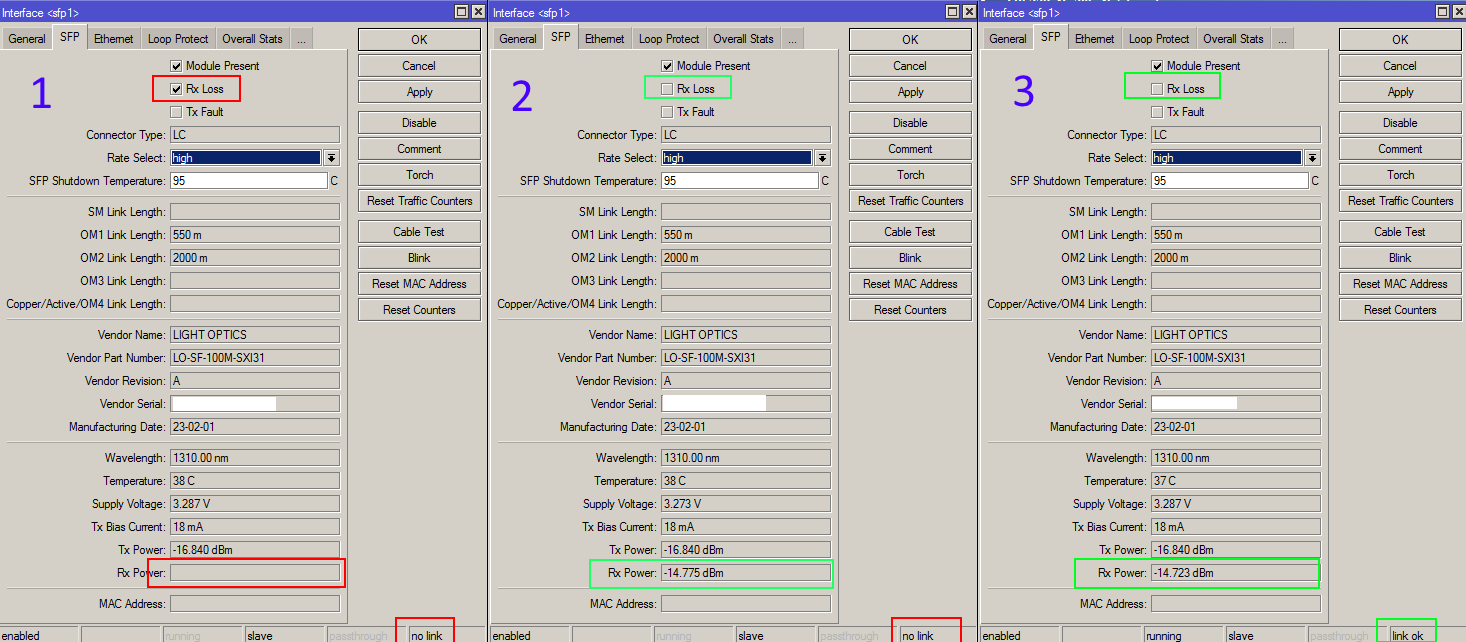

I have a problem with 100Mbps (155M) SFP on MikroTik CRS328-4C-20S-4S+. They should work on this model in all SFP ports according to this:

But there is no communication between them (tried to ping 192.168.89.1 from combo1 port).
Also tried to force 100M on both SFP ports:
set [ find default-name=sfp1 ] auto-negotiation=no speed=100Mbps
set [ find default-name=sfp9 ] auto-negotiation=no speed=100Mbps
This also doesn’t work, except that the links at the SFP ports in MikroTik have lit up and the status “link ok” is in the SFP interface status. Unfortunately, there is no IP communication. TX counter at port status is increasing, but RX is zero.
No firewall applied, no (R)STP on bridge ports.
Same config tested with another different (from other manufacturer) pair SFP 100MBps (155Mbps) and communication also doesn’t work.
Same config tested with few different pair SFP 1Gbps (1,25G) and communication works good.
Tested pair SFP 100MBps (155Mbps) checked on another device (simple media converter Planet IGT-805AT) and works good (same patchord).
Screenshot in attachment:
  1. sfp1 status while patchord is disconnected
  2. sfp1 status while it is connected to sfp9 (autonegotiation)
  3. sfp1 status while it is connected to sfp9 (forced 100M)
    Device info:
    routerboard: yes
    model: CRS328-4C-20S-4S+
    revision: r2
    firmware-type: dx3230L
    factory-firmware: 6.49.7
    current-firmware: 7.11
    upgrade-firmware: 7.11
Any suggestions this would work ?
The document you linked above (about 100Mbps SFP support) is only about SFP slot compatibility (i.e. not all devices support 100Mbps port rate in their SFP/SFP+ ports). But a completely unrelated issue is support for particular SFP module models … ROS unfortunately only works trouble-free with a small number of SFP modules from 3rd party vendors (even proper functioning of MT’s own SFP ports sometimes just isn’t there). So you may want to try with different models of 100Mbps SFP modules and hope some will miraculously work.
Any info if this issue is really ROS firmware/software related or is it a CRS hardware issue? It’s disappointing that cheap media converters work on any SFP module while MikroTik doesn’t…
Maybe SwOS installation could solve the problem ?
