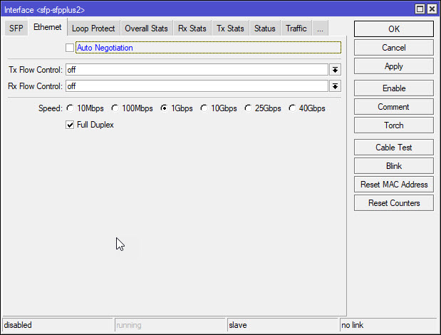

but I still have maximum 1GB and I have to untik the auto negotiation flag othewise the link is off:
