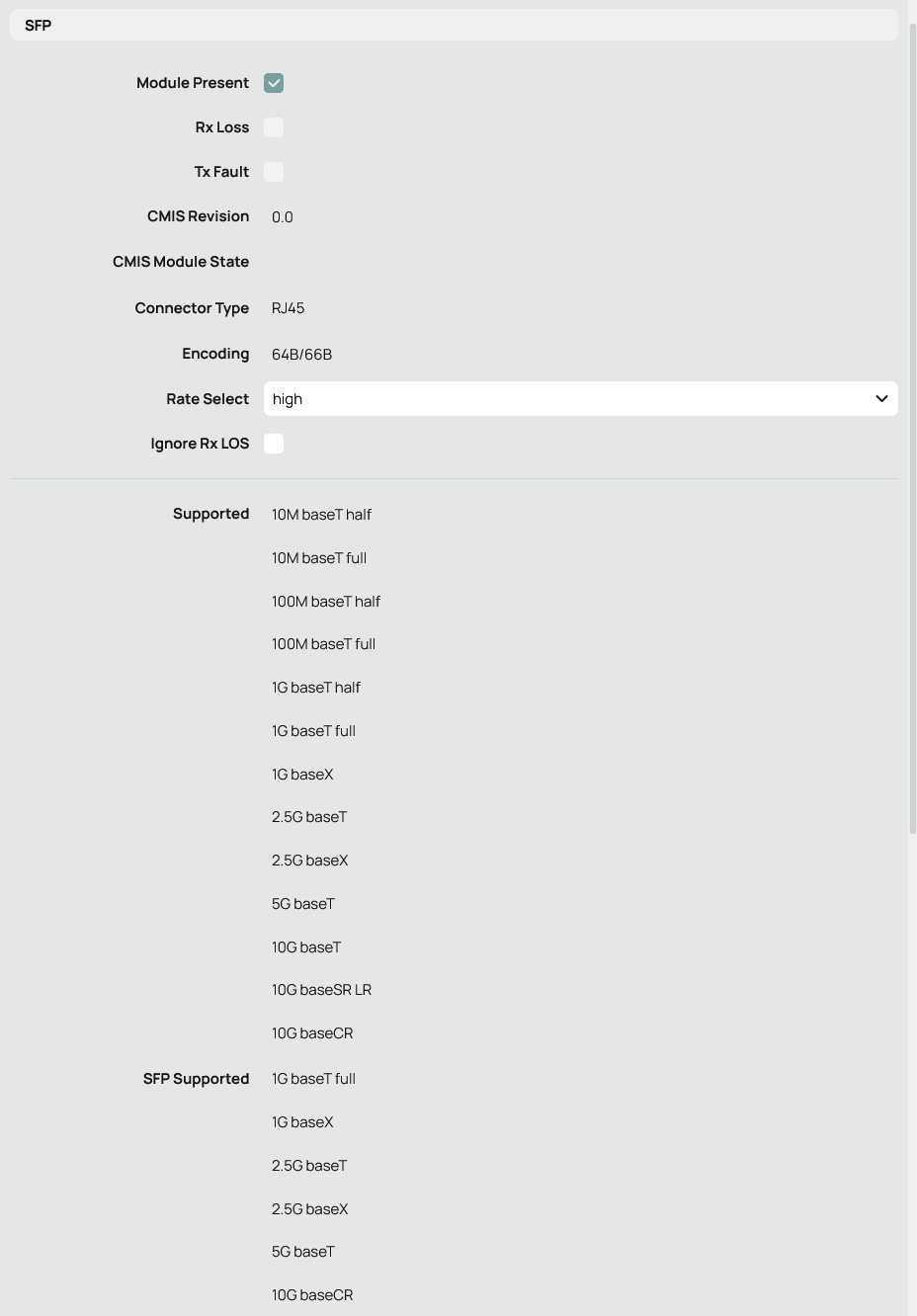

Can CCR2004-16G-2S+ suppport speed 2.5G if I use Mikrotik SFP RJ10 ? I need to connect Mikrotik to 2.5G RJ45 of ONU or switch 2.5G. If not RJ10, are there any other SFP models support for 2.5G? Thank you
The SFP section of your interface answers your question.
"Supported" is the list the interface itself supports.
"SFP Supported" is what the SFP module itself supports.
Shown here on an CRS309-1G-8S+IN with an RJ10.
