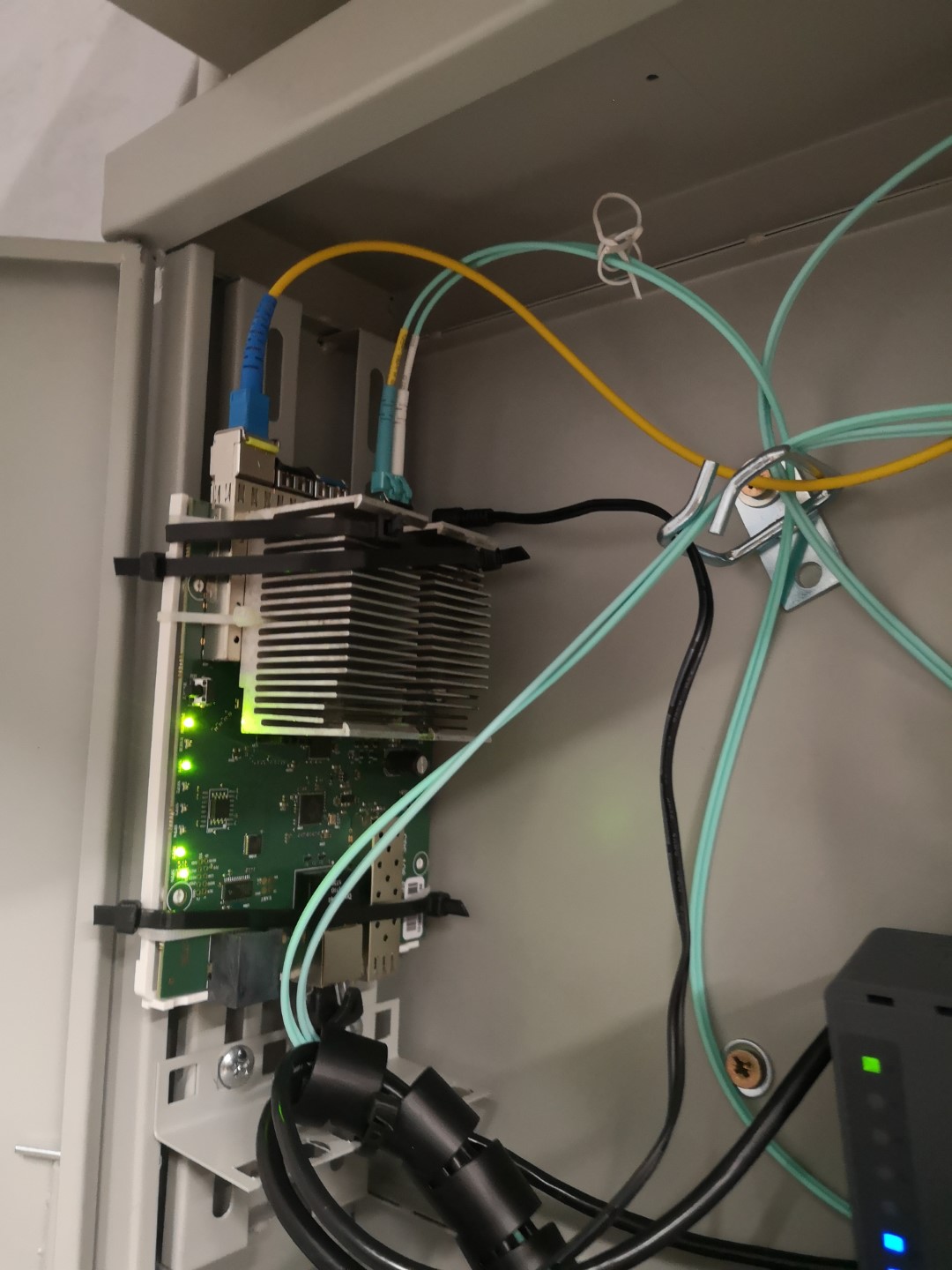

Interesting. As another work-around, do you think these types of heatsinks on the SFP module would help?
i doubt it’d have much effect, as the temperature rises extremely quickly as soon as the interface is enabled and stays very high. there is no airflow in the places we have this issue, hence why heat spreaders would make little difference.

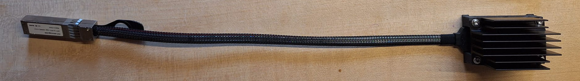

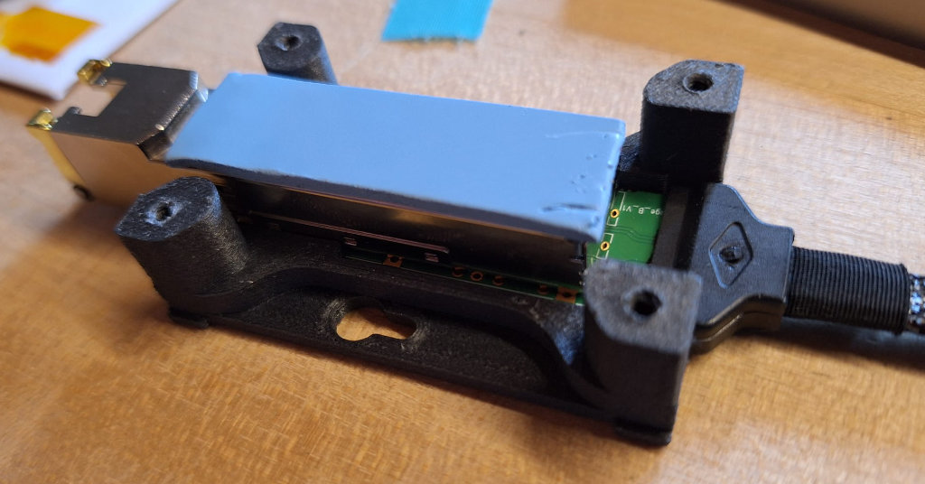

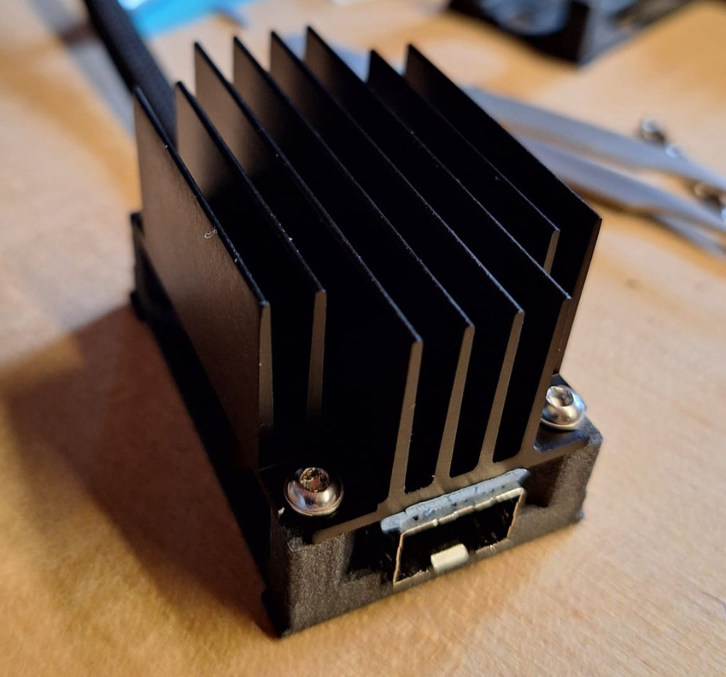

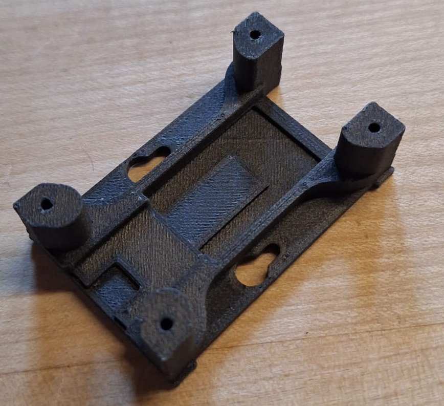

Found an interesting solution using the 10Gtek immersion cooling components. They sell SFP+ extension cables, that came in handy.
I designed a cooling solution around it. The files for 3D-Printing and bill of material I published under: https://www.printables.com/model/896841-passive-sfp-module-cooler
