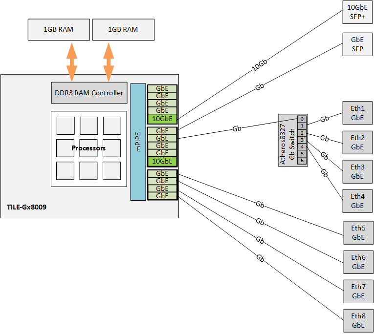

Ports are predefined on Tilera’s chipset, it’s just a matter of wiring them out. Actually I’m quite surprised Mikrotik didn’t wire out every possible port out, so maybe it’s not as cheap as I hope it is :frowning:
Looking at Tilera’s datasheets the CCR1016-12G is the only model (available or announced) that doesn’t max out on ports. It would have had room for one more 10 GbE or four 1 GbE ports. All other models are “fully wired”.
1036 could have 4 SFP+ and 16 SFP for one, and I don’t want to delve into other models. My point is: if it’s not too expensive, it may be worth putting more physical interfaces and let end user decide which they want to use and how. I for one have next to no use for non-optical interfaces :slight_smile:
Nope. It could have 16 x 1 GbE or 4 x 10 GbE or one of these mixes: 12/1, 8/2, 4/3
And that’s exactly what we have. We have an 8/2 model and a 12/1 model.

The Gx36 has four units that can each act as single 10 GbE or four 1 GbE ports.
The Gx16 has one unit that is 10 GbE only, 1 that acts as one 10 GbE or four 1 GbE ports and two units with each four 1 GbE ports.
The Gx9 has two units that can each act as one 10 GbE or four 1 GbE ports and one unit that has four 1 GbE units.
The written specs fit the block diagrams within the datasheets.
And yes you’re right, it’s a CCR1009-8G-1S-1S+ . All these numbers get me confused :wink:

My understanding is that it needs all the 4x1G lanes attached to do 10G signalling on the link. Tilera reports that the ports are “multiplexed” and from all the documentation it appears to be 1 x 10 or 4 x 1.

Are you sure they are all booked out?
Looking at the TILE for the 1009, if I draw the datasheet to the ports used on a CCR1009 it looks like there is a spare 10G and a few 1G ports available? OR have I understood that incorrectly?
Also its unusual they have only used one of the 3 1G ports for uplink on the switch chip (the crs226 uses 2 Gb uplinks to the next level switch chip).
How are others using the CCR for high performance and 10G? Im after a bit of input.
The whole 10G thing is confusing. There is only 1 * 10G port (on the CCR1009), so either you can have that as your WAN but not be able to aggregate enough from the 4 available Gb direct to CPU ports or use the 10G to the LAN/Switch (for all LAN VLANs) a 1Gb in from WAN.
The if you plugged the 10G into a CRS226, they use 2*1Gb uplinks between the main switch and 1/3 grouped sub switch chips, so the bottleneck reduces it to 2Gb. Then because the wirespeed switch cannot aggregate / LACP, you end up back to 1Gbps.
You can’t use both 10G and 4x1G from what Tilera said. Not easily at least. So 8x1G + 10G is maxing it out.
