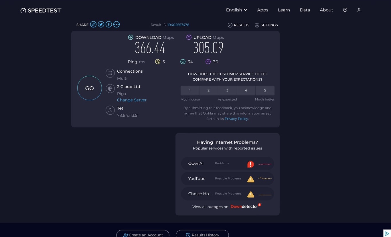

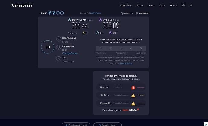

Now I am happy to announce I have successfully deployed Mikrotik on a legacy 2-wire connection between 2 objects in my home and achieved 300 to 400 Mbps speedtest which is absolutely OK for me.
Hardware used:
Central unit: Mikrotik L009 with SFP card Zisa GHN381
Remote unit: Zisa GHN381S media converter with SFP card GHN381
both connected with 2 wires phone cable. The connection is Layer 2 transparent, DHCP works over seemlessly as if it was regular Ethernet.
