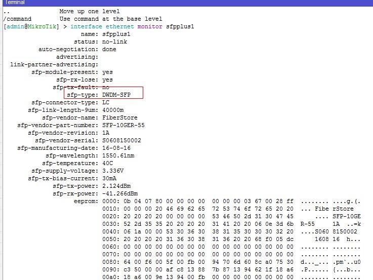

Just a note to say that using the new RC versions there is a command
/interface ethernet monitor “interface”
This showed me that these models were being recognized as DWDM-SFP - which apparently is not supported on Mikrotik. I am going to RMA them to configure a LR SFP tag on them in order to work.

Basically from what I can understand from fibrestore is that these should have been programmed as ER and not DWDM, so fault is on their side. Strange one though.
If sfp-type shows DWDM then these modules are not going to work, modules need to be reprogrammed so that first byte show 03h.
Thanks they are going to re-program. Any idea why they do work in the normal SFP ports though?
SFP+ PHY has its own firmware that may not like these modules, for regular SFPs there are no such thing. To answer exactly why it works in one slot and not in another then we need exact modules to test and investigate.
