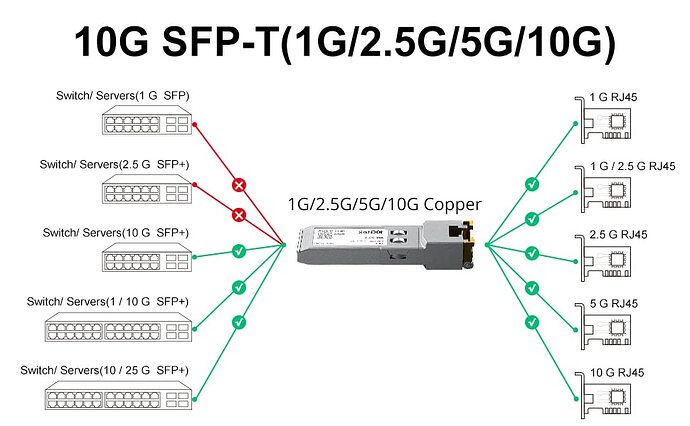

I bought this SFP and it works fine.
https://www.amazon.es/dp/B0BG55X2P9

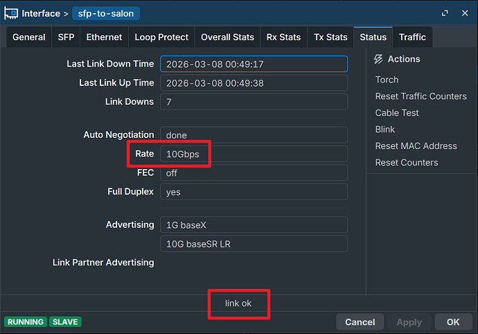

RB4011 Side:

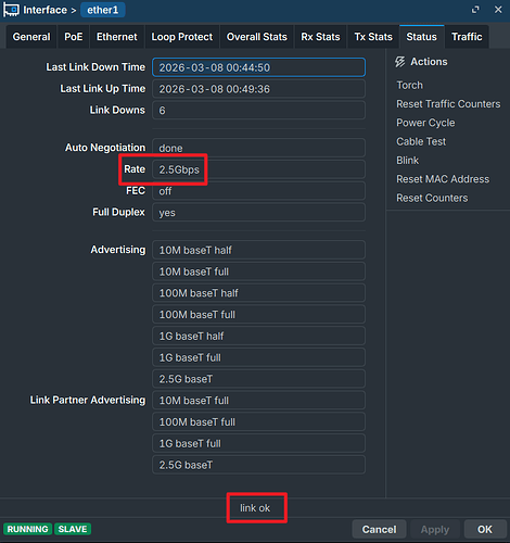

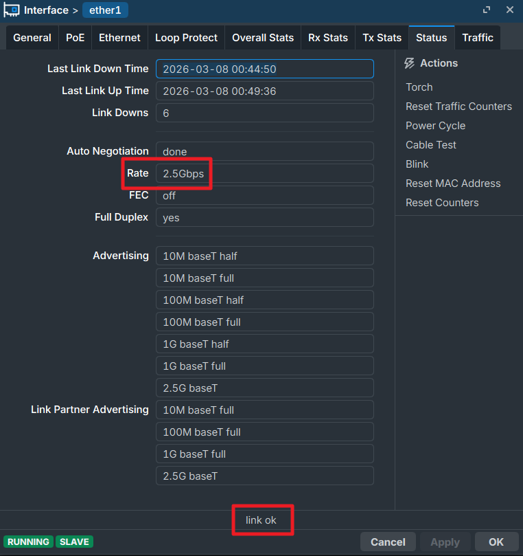

hAP ax3 Side:
(Port 1 of 2.5G)
For this type of SFP, the connection inside the RB4011 will always detect a rate of 10 Gbps, and on the outside (RJ45) there is a small switch that will synchronize to 1 Gbps, 2.5 Gbps, 5 Gbps, and 10 Gbps. Tested.
