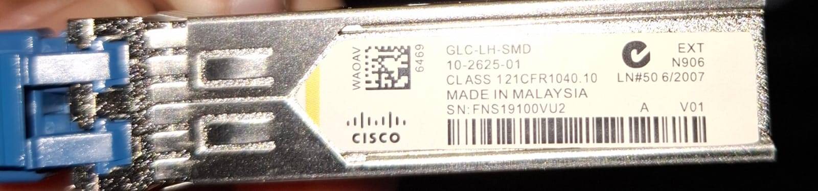

So I connected the SFP port in CCR2004 with My new CRS326 SFP but the connection doesn’t work..
is there is any thing that I have to change in the configuration between two devices in order to work..?
here is a photo for the SFP that I used..

Is it mandatory to use a MikroTik SFP in order for the connection to work?
Not that I know of.

The fiber patch cord is okay and very clean. The only thing I am skeptical about is the SFP. Is it compatible with MikroTik?
Probably not (entirely). ROS support for SFP modules is very incomplete and fragile, only a handfull of 3rd party modules were tested to work with ROS ever. And even own MT’s modules may not work without any issues with MT’s own devices, just have a look at official wired interface compatibility list.
