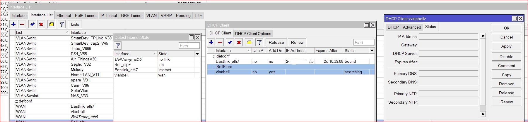

If you needed visual representation…
The weird things is (never have used internet detect before) is that IDetect shows Bell_SFP+ as a LAN detection whereas,
no where have I stated any such thing. Although cut-off if you look at the interface list, you will see its identified as a WAN interface ???
