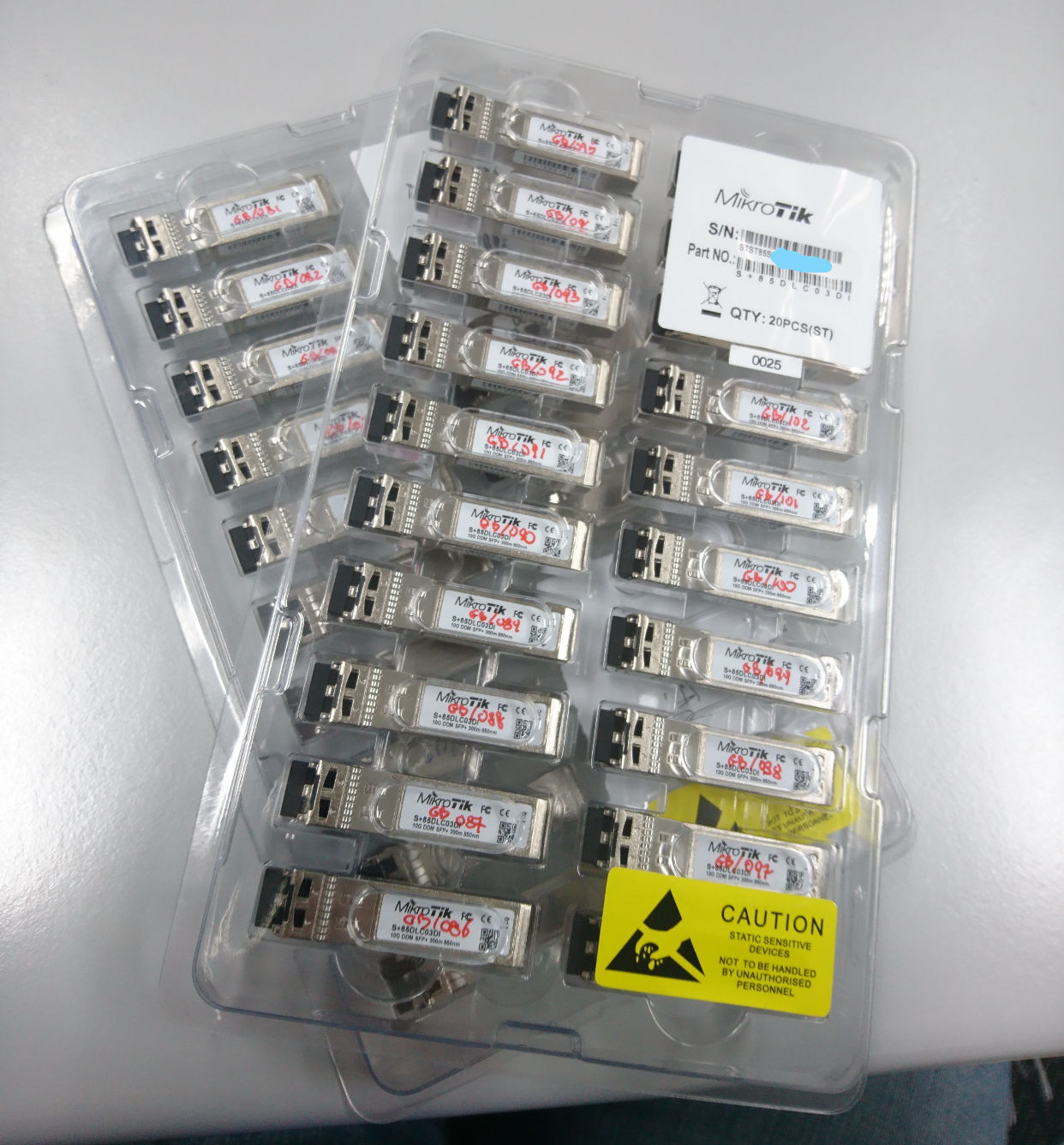

Hi all,
What is maximum reachable distance with a S+85DLC03DI? We bought some S+85DLC03D but S+85DLC03DI arrived and we are having problems with links (flapping) that become stable when we disable auto-negotiation and set link speed 1G.
Links are between CRS328 and CRS317, distance is approximatly 50m.
Why does S+85DLC03DI report a sfp-link-length-50um of 80m instead of 300m?

Hi Mikrotik Team,
please post more details S+85DLC03DI vs S+85DLC03D.
In this moment, all our S+85DLC03DI are useless…
