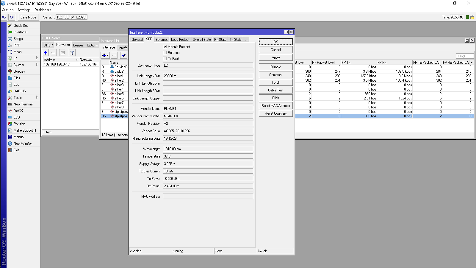

I plugged a SFP module into a CCR1036 SFP+ port.. This does not work. Well the router sees the module. Its sees the signal levels. It transmitts data… BUT the SFP only switch on the other end does not link..

Oh really ? Hmmm, never considered that. No wait, I don’t think that is the issue because on the Mikrotik side it shows a signal level for transmit AND rcv. If they were backwards, there would be no signal on on eof them right ? Also the module seems to show its hooked up. It shows link OK.. I have now tried 3 different brands of SFP modules. It all works when plugged into a SFP switch CRS112-8P-4S-IN
SO If i simply unplug the module from the CRS and plug into the CCR SFP+ port it does not work no matter what I do.

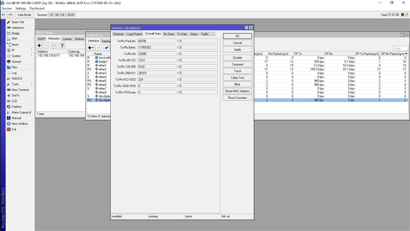

The CCR shows the link as OK, bu the device on the other end does not link. No data flows even tho the CCR attempts to send data..
