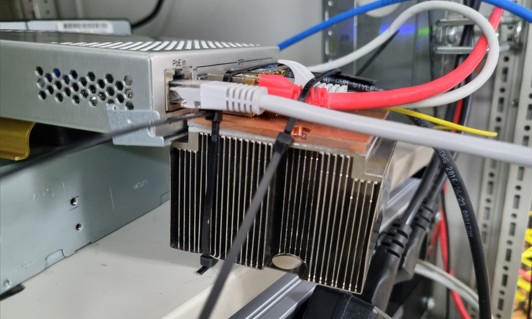

A. Old server radiator fastened to external parts of modules. No thermal pads … just “toch of copper”. No special change in temperatures 76C but “overheating” message disapperaed.

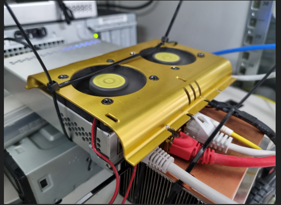

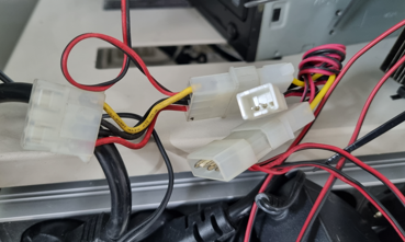

B. An old HDD fan cooler - “vintage” connectors from the unknow territories of drawers helped a lot - and full success 42 - 50C degrees when transmitting. Maybe 5V is enough to power these 2 fans or maybe a speed regulator could be used.

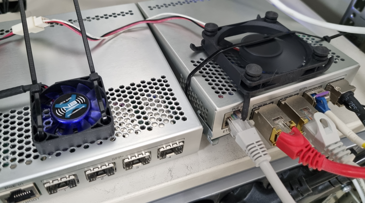

Last test to prove that “size matters” :slight_smile:
Left small silent 40x40 fan keeps 55 degrees but the right one is enough to keep 46degs

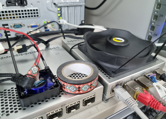

OK, BartoszP - I LOVE the zip ties holding it together. I know it was a temp test, but I loved it.
At this rate, wouldn’t a 12cm, low speed, fan be better? I mean, this device IS 12cm across, isn’t it?
I have only 90x90 12V 4pin spare one.
Powered with 12V, no regulation & pedal to the metal, gives ~46C, 5V means silence&slow motion but ~60C.
Conclusions:
  • the constant intensive air stream is needed to let it go through small sieve-like holes if you mount fan on the case
  • smaller silent 40x40 fan has same efficiency as slowed down 90x90
  • small fan could be sufficient without metal case but who knows?
@k6ccc
forget zip ties, watch that fancy folk tape used to temporary hold power cables in the plug, you should be really unable to sleep for love now :laughing: :laughing: :laughing:
I don’t know exactly, only judging from photographs … but device seems to have majority of holes on the top surface and only little elsewhere. With fan covering all top holes, air is pushed out through (scarce) holes at other parts of device, so air speed might be relatively low. With smaller fan air can escape through remaining holes on top of device, allowing for lower needed presure … and since lots if heat is generated by SFP modules this means that heat can escape via shortest path and doesn’t heat the rest of device components.
Plus: large fan pushes lots of air against solid surface wasting energy. In this aspect the solution of old HDD cooler seems better, both fans roughly cover holes on top of device.
From heat management perspective it would be better to suck hot air from top holes … so that cold air enters through the rest of holes and hence cools the rest of device.
My idea behind 12cm fan was less noise. 5V is a bit too low, I’d use about 7 - 9v.
I thought that the case was about the same up and down. Aren’t there any holes down? If there aren’t, the bigger fan would not work - as already pointed. My problem with 4cm fans is the noise - the bigger, the better in this case.
If air is pushed into a case then the stream reaches SFP cages directly as they are near, the stream is perpendicular to them and not too disturbed yet (except the case holes problem). When the fan sucks out the air then stream takes the easiest/fastest path so in effect it could not touch the space between SFP cages. On the other hand, when the jet is pushed inside, it cools the other elements too.
I would check 9V :slight_smile:
Yes, this is as old as fans, is it better to blow air or suck it? :question:
And the answer - as often happens - is “it depends” (but it costs nothing or very little to try the fan flipped over).
If the fan is in contact or very near to the surface to be cooled, sucking should be in theory more efficient, but you never know until you try.

The big 12V fan, as on the last picture, powered @7,5V instead of 5V gives ~47C degs under traffic on both S+RJ10. DAC cable reports nice 4C degs :slight_smile:
