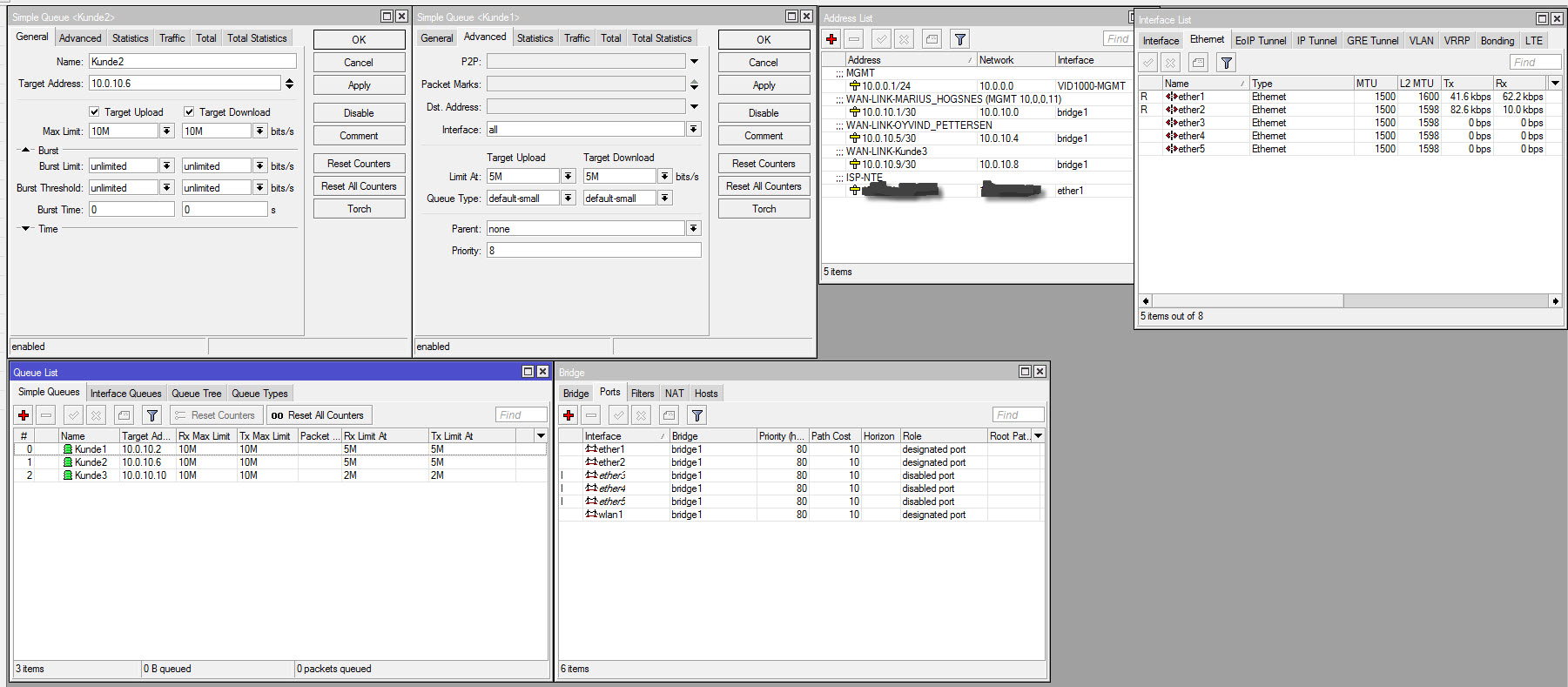

We are 4 neighbors going to share on a 10/10mbit internet connection. I have been able to setup it up correctly and have a link between the basestation and the clients.
I wanna set it up so that if for an example only 2 clients are using internet they will share equally on 10mbit, but if CLIENT_1 only using 2mbit, CLIENT_2 will bee able to use 8mbit.
So all 4 clients will be guaranteed 2,5mbit, if it exist free bandwidth they will be able to use up to 10mbit.
I hope this made sense. I have Attached my setup With Queue my existing Queue that is not working as it should. In this attachment we are onlu 2 klients that is Connected the last two is going to Connect when everything is working and hopefully more customers to come.
Øyvind

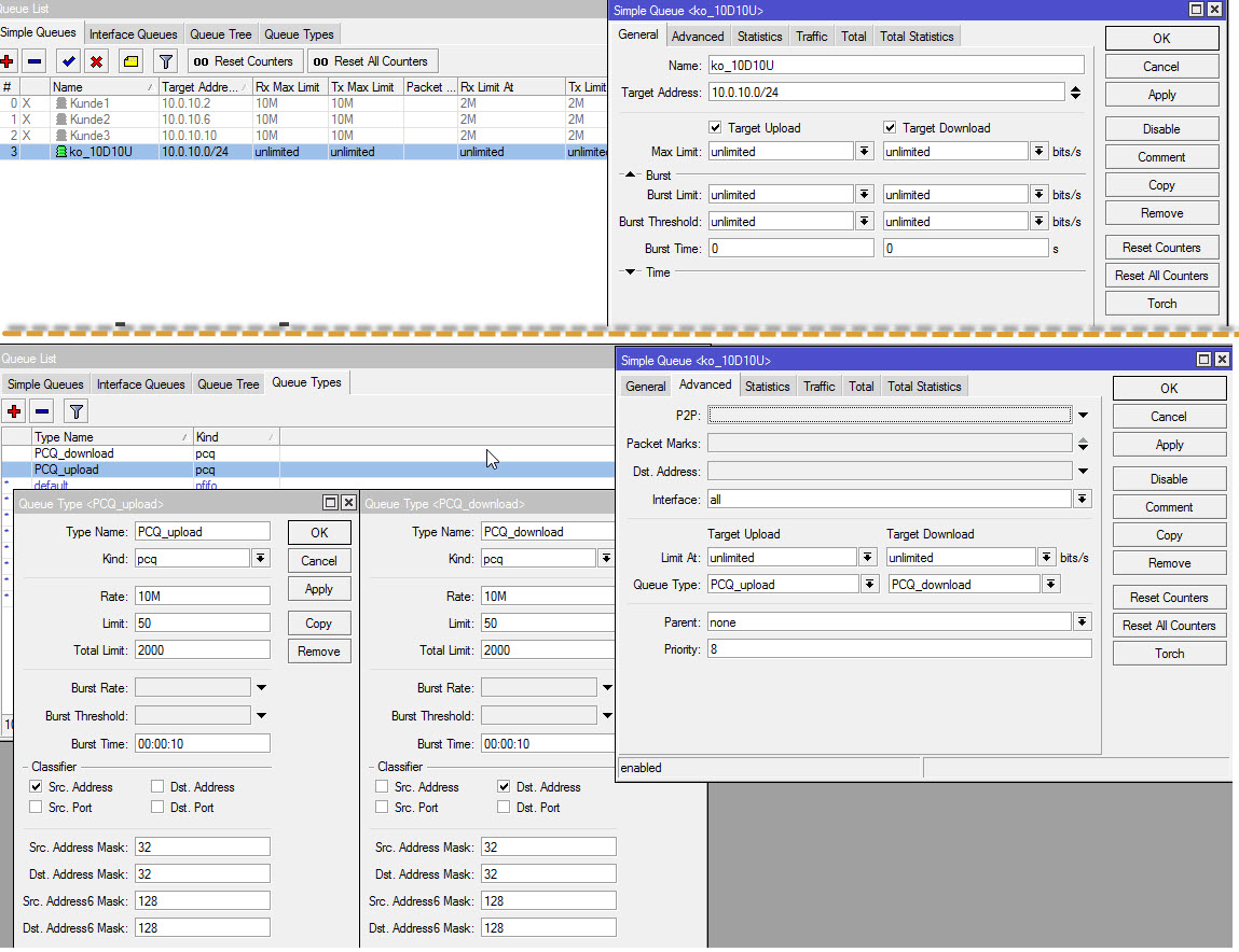

Ok think im getting there. Much simpler than i tought if this is correct, see screenshot.
But where can i set the lowest guaranteed limit?(2,5M)(4 “customers”)
