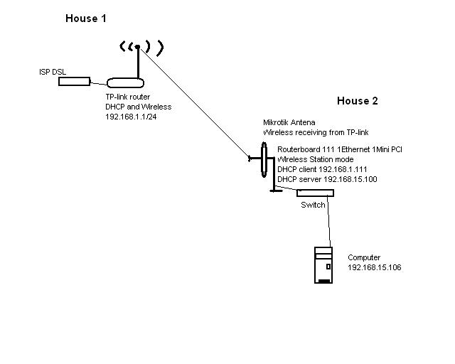

Sharing coneection between to house using wireless
OK, House 1 for my house and HOUSE 2 for my fiends house
I want to share my internet with my neighbored I have a TP link router with wireless at my house, so I decide to install a wireless rootena at the house of my friend there is a line of sight because it leave at from of my house.
I set the SSID and the security profile so no one can used and the wireless connection is working TP-Link router and Mikrotik
I set a DCHP client on the mikrotik side and is receiving IP from TP-Link
DHCP client=Wlan1 192.168.1.111
DHCP server=Ether1 192.168.1.106
this is the only way that i Maded work, what i want to do is eliminated the DHCP server from mikrotik so in the house of my friend he can receive IP addreses from TP-Link to eliminated a NAt behind nat… because we are experience problems with P2P connections
I am able to ping the TP-ling from the house of my friend
