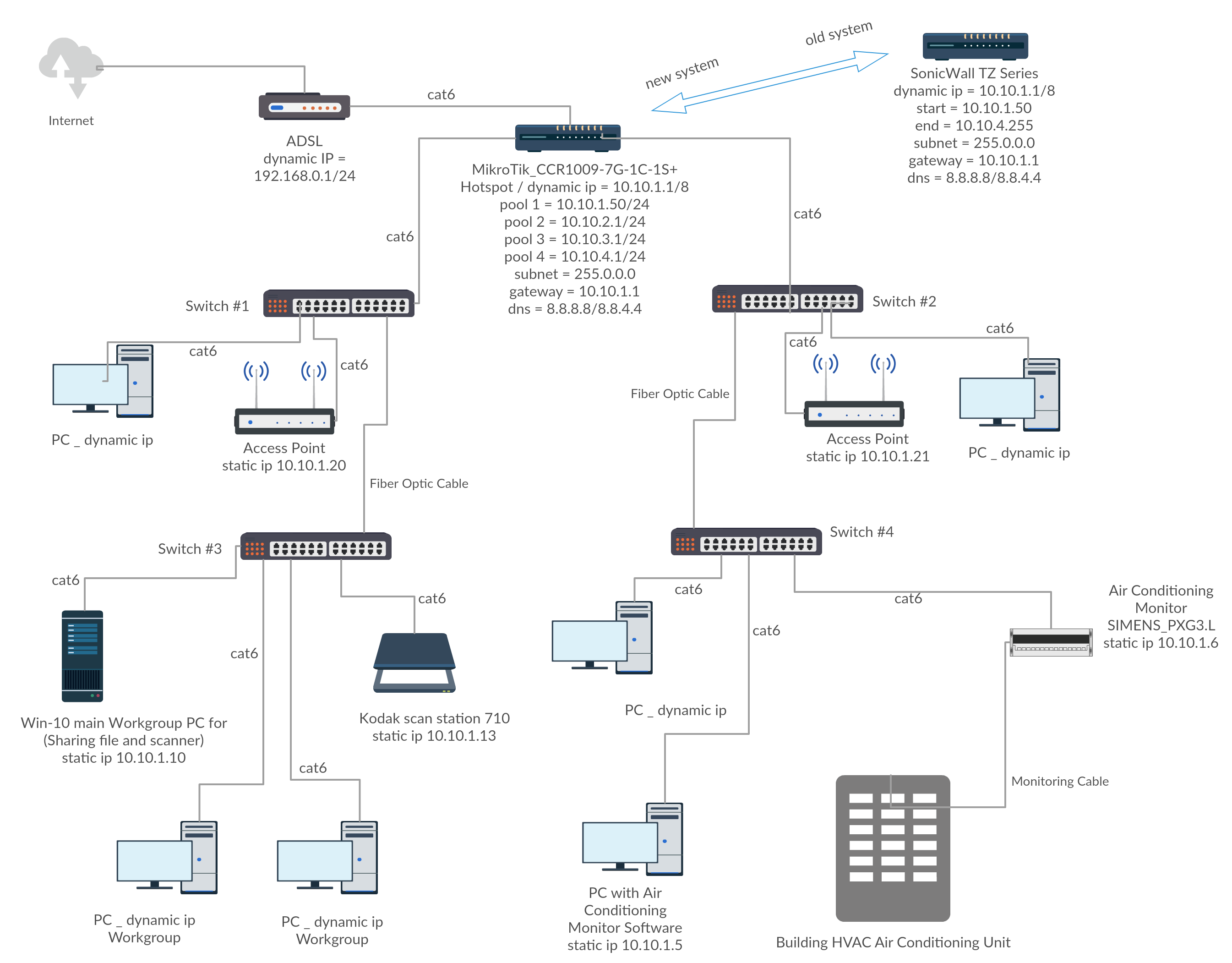

After change office router from (SonicWall TZ Series) to (MikroTik CCR1009-7G-1C-1S+) we got problems in the network, so I hope somebody help us, below the issues:
1- Some computer has “Workgroup sharing file” some time not working (Main Workgroup PC is static ip 10.10.1.10 .
2- also there’s cloud scanner (Kodak scan station 710)
with static ip 10.10.1.13 , should save the file in to Main Workgroup PC 10.10.1.10 ,but not working.
3- Also there’s Air Conditioning Monitor device
(SIEMENS PXG3.L) static ip 10.10.1.6 , this device connect through office network and Monitor with one computer has Monitor Software static ip 10.10.1.5 , this should see all data but we couldn’t .
For your information we can ping all ip address and all address retch to internet also if we return back to old router everything will work fine! I’m sure we configuration correct address on Mikrotik as the old router.
The attachment the script and network layout.
