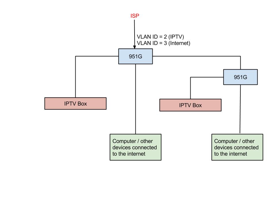

My ISP gives 2 VLAN (internet & IPTV). What I want to do is to have these VLANS available on a second Mikrotik device (see setup picture). Both are Mikrotik 951g-2nd.
The closest I could get is only sharing the internet line, but unable to get IPTV on the second Mikrotik.
Please advise how to setup. Thanks!

To permit internet vlan access to closest 951G, you have to setup ports connected between 951G´s on internet vlan (vlan 3). Ports will use like trunk vlan ports allowing only vlan3.
I hope the answer was helpful…

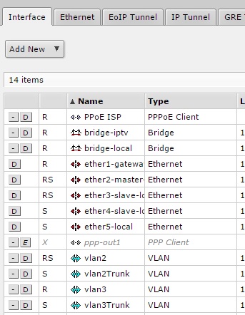

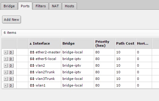

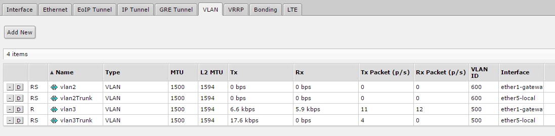

Thanks. I read some about trunking and tried that to share vlan2 & vlan3. So far, i am un-successful in sharing both vlans. I only manage to share one vlan at a time only.
If trunking is the correct method, could you please look at my configuration that I tried below. I am attaching the trunks to ether5 port.
