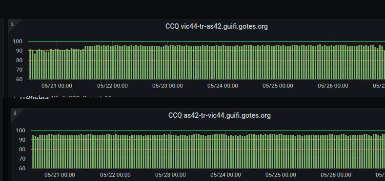

We set up a link with a pair of SXT Sq AC (RBSXTsqG-5acD) covering a distance of 330m for serving some clients. After adjusting both units, selecting proper channels and frequencies we put this link on production with an overall CCQ above 90% (attaching a graph of gathered CCQs of the last 7 days). TX power in both units is below the maximum recommended for AC at MCS9 and RX signal is -58/-59 dBm. We monitored the spectrum and it seems we’re the only ones on this channel, so link should not have any problems and work perfectly. Bandwith test shows a througput of about 200mbps. Not very worried about that.
Shot of CCQ graph:

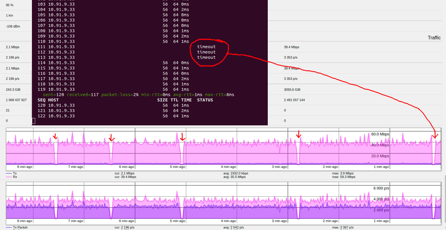

However, after some days in production we realised that the link losses some packets when it has moderate traffic (around 30mbits/second down and 4-5 up). This losses happen approximately every 2 minutes and only last for about 2-3 seconds. When there’s no traffic, this doesn’t happen. What surprises me more is the fact that not only icmp packets are lost, but all packets (even the ones causing the moderate traffic) and with a suspiciously stable periodicity and duration. Replicating this problem is not easy but yesterday I managed to catch a screenshot of this behaviour:
The characteristics of this incident (like its periodicity and the complete loss of the links throughput) and the fact that all wireless metrics seem OK makes me think that it could be more a hardware/ software problem.

Yesterday I managed to replicate the event. Made a bandwith test up, down and both. Things get interesting because it seems to only happen when the traffic is on both TX and RX.
