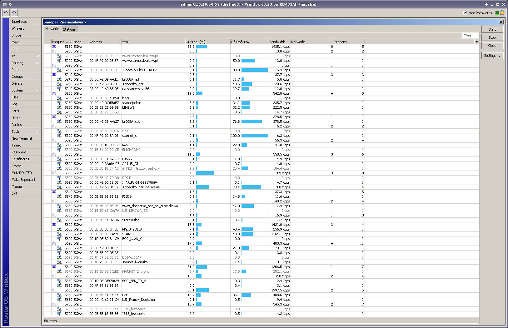

Here are screenshot: http://michal.linuxstuff.pl/snooper.png
All stations with “sloneczko” string, is my stations.

It’ seem you place all the channel been use.
