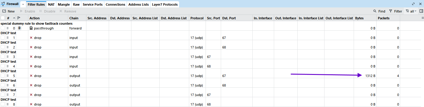

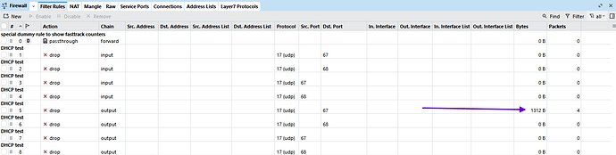

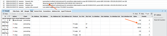

Ok, here is a demo: Let's add these ultimate blocking rules at the top of RAW and Filter:
add action=drop chain=input comment="DHCP test" dst-port=67 log=yes protocol=udp place-before=0
add action=drop chain=input comment="DHCP test" dst-port=68 log=yes protocol=udp place-before=0
add action=drop chain=input comment="DHCP test" log=yes protocol=udp src-port=67 place-before=0
add action=drop chain=input comment="DHCP test" log=yes protocol=udp src-port=68 place-before=0
add action=drop chain=output comment="DHCP test" dst-port=67 log=yes protocol=udp place-before=0
add action=drop chain=output comment="DHCP test" dst-port=68 log=yes protocol=udp place-before=0
add action=drop chain=output comment="DHCP test" log=yes protocol=udp src-port=67 place-before=0
add action=drop chain=output comment="DHCP test" log=yes protocol=udp src-port=68 place-before=0

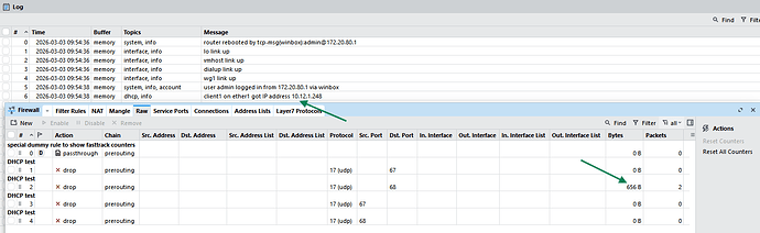

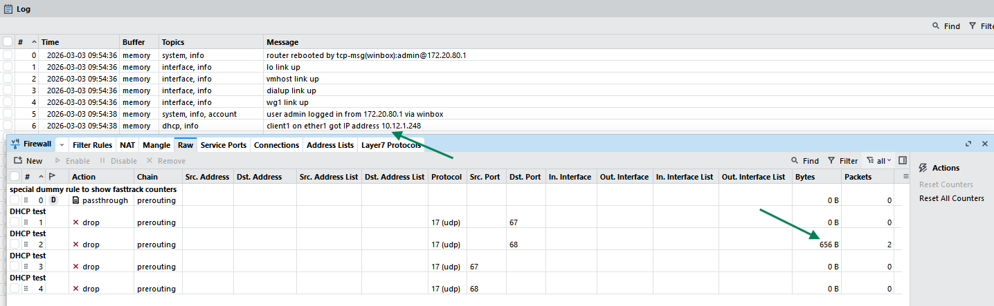

/ip firewall raw
add action=drop chain=prerouting comment="DHCP test" dst-port=67 log=yes protocol=udp place-before=0
add action=drop chain=prerouting comment="DHCP test" dst-port=68 log=yes protocol=udp place-before=0
add action=drop chain=prerouting comment="DHCP test" log=yes protocol=udp src-port=67 place-before=0
add action=drop chain=prerouting comment="DHCP test" log=yes protocol=udp src-port=68 place-before=0
And reboot the router. After reboot, router happily gets IP address via DHCP client on ether1:
Drop rule in RAW prerouting is hit twice.

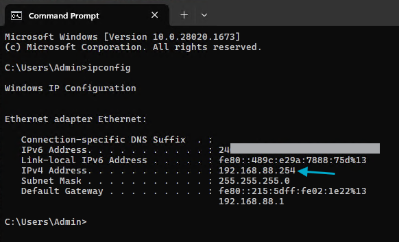

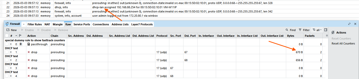

Then I fired up a Windows test VM, which is the sole client of the test router:
Windows client get 192.168.88.254 assigned by the DHCP server on the router, although the drop rules counted packets:
On the filter table, all rules in chain input counts nothing, because packets are already dropped in RAW. A single rule in chain output counted some packets that it dropped, these correspond to packets sent by the DHCP client on the router:
But as we have seen above, that dropping has no effects because the DHCP client on ether1 had no problem obtaining IP address.

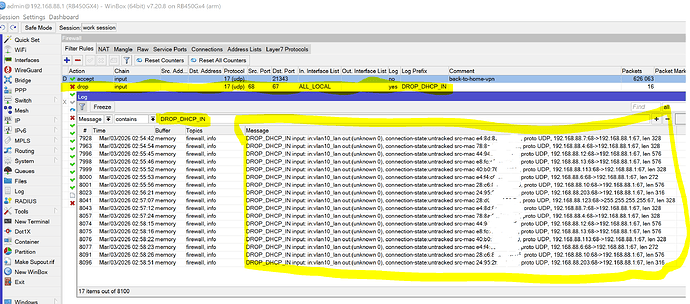

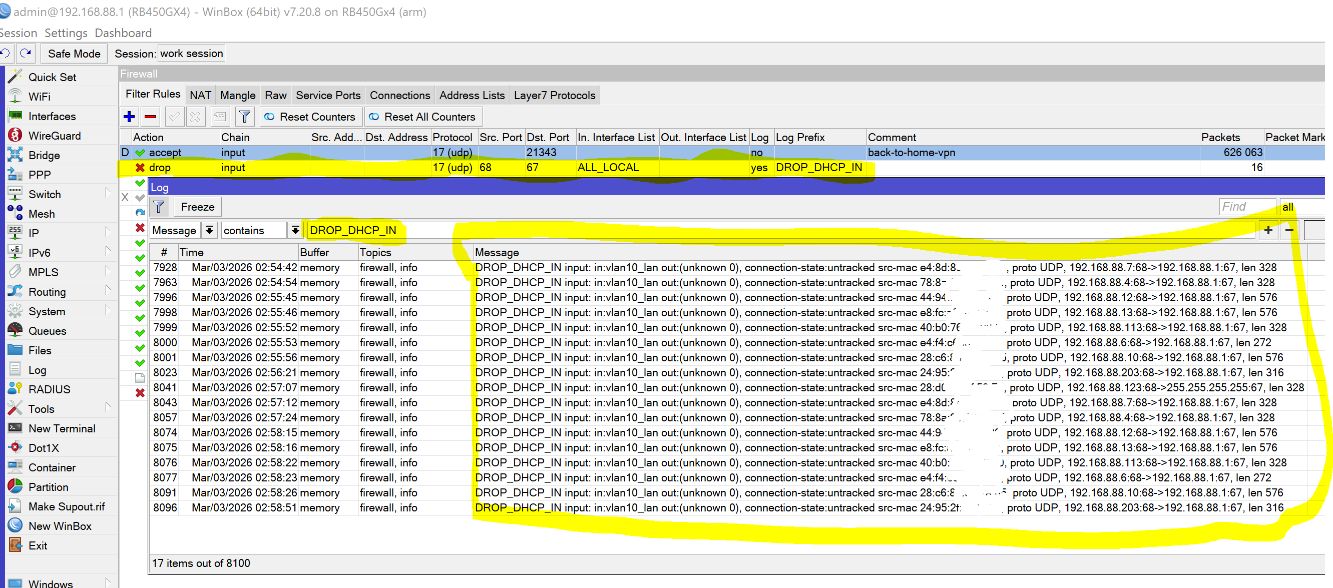

So I did run a quick test dropping inbound protocol=udp src-port=68 dst-port=67 from all local interfaces.
The firewall rule has no effect indeed.
What is interesting is that the rule gets hits, and the log shows the DHCP packets "dropped" (?) but DHCP clients continue getting their IPs.
Clearly this is Mikrotik circumvented their own system, which can best can be described as "a dirty hack". I can understand why this is done, however.
Here is the screenshot:
It is the same mechanism as is used by the “packet sniffer”. You can sniff any packet on the ethernet interface also when it is blocked in the firewall.
This is not MikroTik specific, it is a Linux feature and probably exists on many other systems.
What is not clear is how you were able to block it before, but that probably was a mis-diagnosis of another problem. It worked this way in v6 as well.
