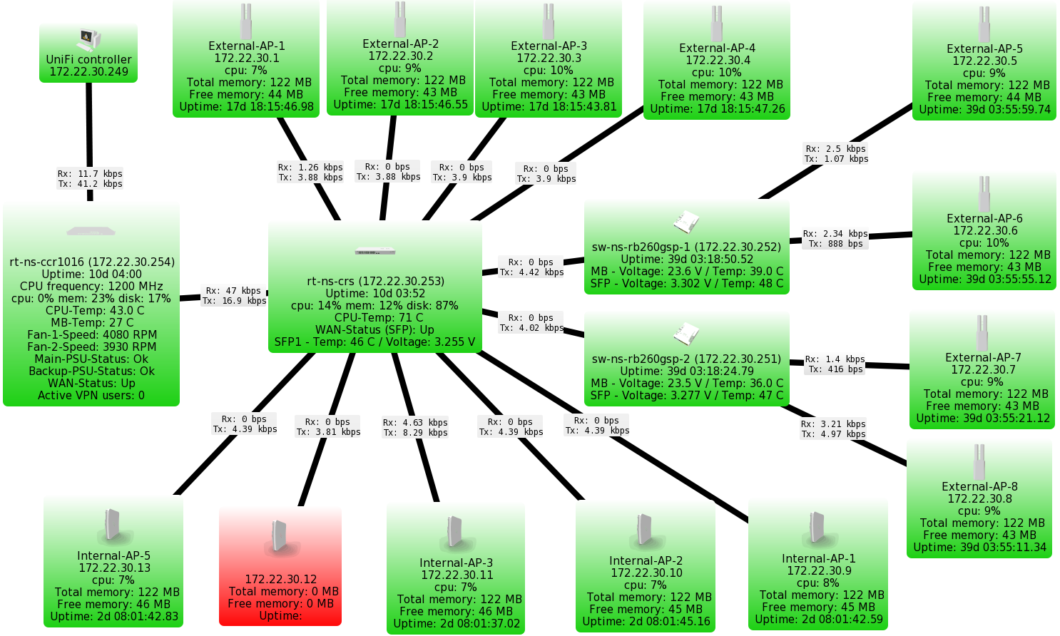

I have two “places” that have almost the same number of Wi-Fi points. In both “places” there are external and internal access points. Option from Ubiquiti - it’s set up once and forgot. But the version from MT - is associated with a constant “struggle”. IMHO.
I have no complaints with Ubiquiti, it’s been running for years with no faults at all. Only issue was a cable to one AP. Might be better not to fix something that isn’t broken. It’s annoying they are adding features like docker containers while still not fixing wifi issues.
