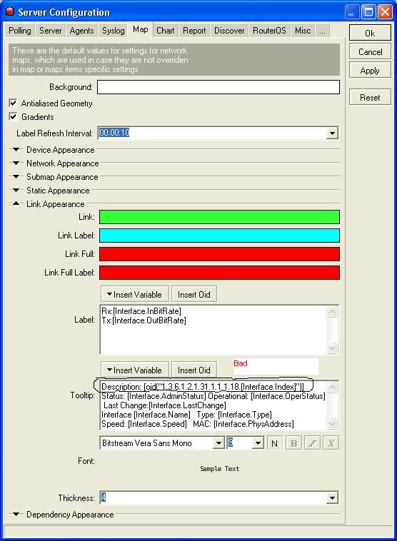

I put it in the tool tip for the global settings under settings, map, link-dropdown…

you can see the link description OID added directly to the tooltip for links…

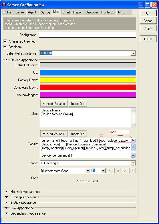

Here you can see the UPS Function added to the tooltip for devices…

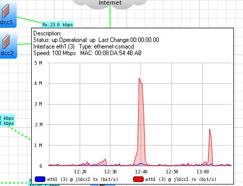

The next 2 screenshots are in the next post shows what it looks like on a tooltip when the OID doesn’t exist.
That doesn’t happen when you use a function. When you use a function and the OID is missing it shows nothing.

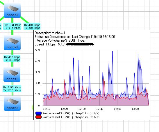

I didn’t make a shot of when the function works works and the 2nd shot in the next post is what it looks like to have the interface description show up on a link that has the OID… All I need to do is move the cisco interface description to a function. Just not doing anything in the dude today :slight_smile:
Either way it works but It is just a matter of making the tooltips look their best and you can add more things on the tooltip using the function and still have it display nice.

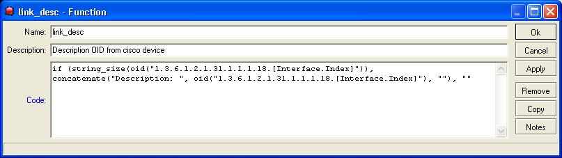

Well I tried to make the description into a function and I get invalid OID :frowning:
Can anyone tell me what is wrong with this?
if (string_size(oid(“1.3.6.1.2.1.31.1.1.1.18.[Interface.Index]”)),
concatenate("Description: ", oid(“1.3.6.1.2.1.31.1.1.1.18.[Interface.Index]”), “”), “”)
I noticed the missing ) in the graphic it was just a paste error…
